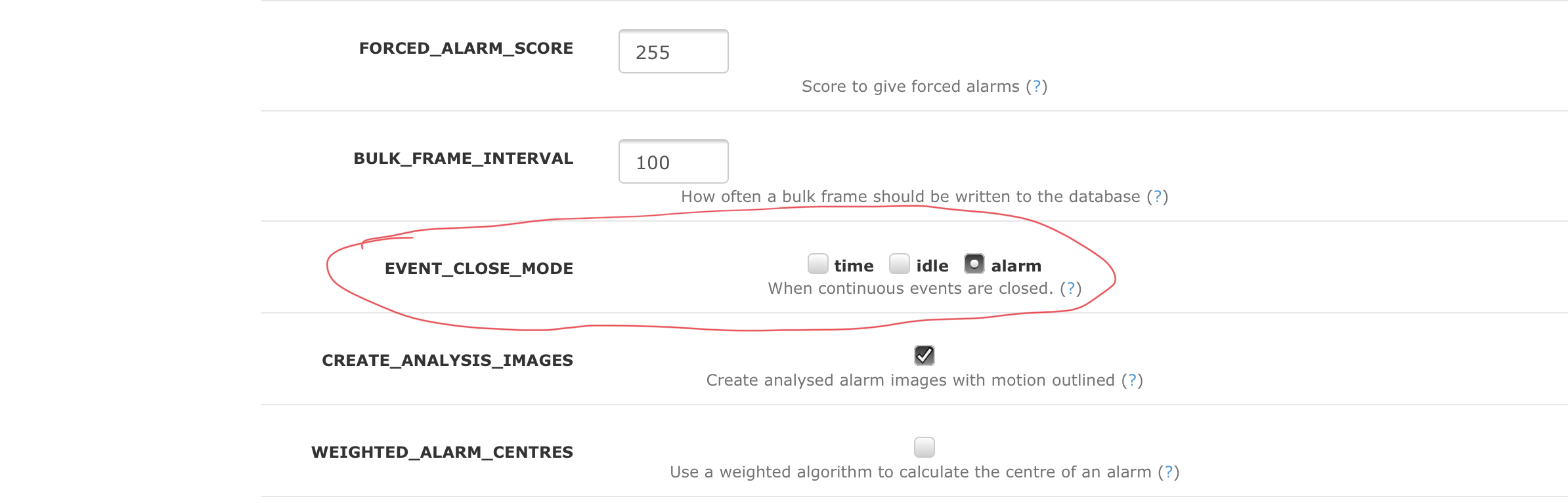

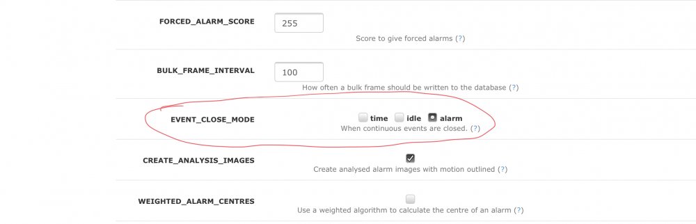

Small PSA on mocord and zmninja and notifications.  If you run Mocord, by default you get recordings every 10 minutes.  zmninja/eventserver ties notifications to the event ID, so that if multiple motion events trigger within the same 10 minute window, you will only receive the first notification and in the timeline you will only see the 10 minute chunks.
The workaround I found here:
I was thinking about this today. One issue is a lot of folks I know use mocord and unless they choose the option to close the event when the alarm is detected (most don't, I do), you will not get a notification for 10 minutes (default segment value) till the event occurs, which to many defeats the purposes. For modect, it is not an issue.
You can find the aforementioned setting under CONFIG
and the help section
ZM_EVENT_CLOSE_MODE
When a monitor is running in a continuous recording mode (Record or Mocord) events are usually closed after a fixed period of time (the section length). However in Mocord mode it is possible that motion detection may occur near the end of a section. This option controls what happens when an alarm occurs in Mocord mode.
The 'time' setting means that the event will be closed at the end of the section regardless of alarm activity.
The 'idle' setting means that the event will be closed at the end of the section if there is no alarm activity occurring at the time otherwise it will be closed once the alarm is over meaning the event may end up being longer than the normal section length.
The 'alarm' setting means that if an alarm occurs during the event, the event will be closed and a new one will be opened. So events will only be alarmed or continuous. This has the effect of limiting the number of alarms to one per event and the events may be shorter than the section length if an alarm has occurred.

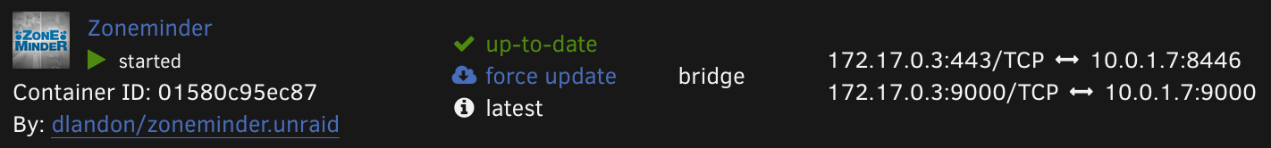

Is it possible to refrain from using ports 443 (common SSL) and 8443 (SSL port used by Unifi)? Port 8446 seems available so far @dlandon 😃
Just change it in the template to 8446.

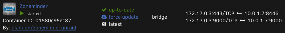

I tried about ten times yesterday to try and get the docker working. When I installed it in host mode, it would stay running but trying to load the interface would take me to the unRAID login.. at 443. Putting it in bridge mode, I can change ports.. sorta (shows as 8446:8443 or the other way around), and repeatedly ghost stops itself.
I need to find a way to delete the "docker0" network route among my other issues, hence the 172.17.x.x address.
Edited by SLNetworks
Add content
Use the default setup and then click on the docker icon and select 'WebUI' to get the the interface.  Leave it in bridge mode.
I got to a page asking me to allow the security exception, clicked to accept and got a blank page. Went to check if the container was up - it had stopped itself.
What does the docker log show?

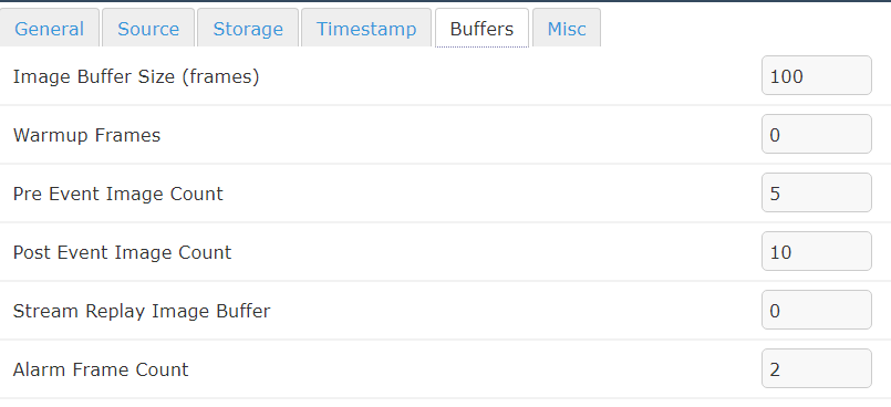

Check your camera buffers:
These are the settings I use and I have no problems.
I changed camera buffer based on your data.
Now Load: is  10.04 and /dev/shm is 38%.
