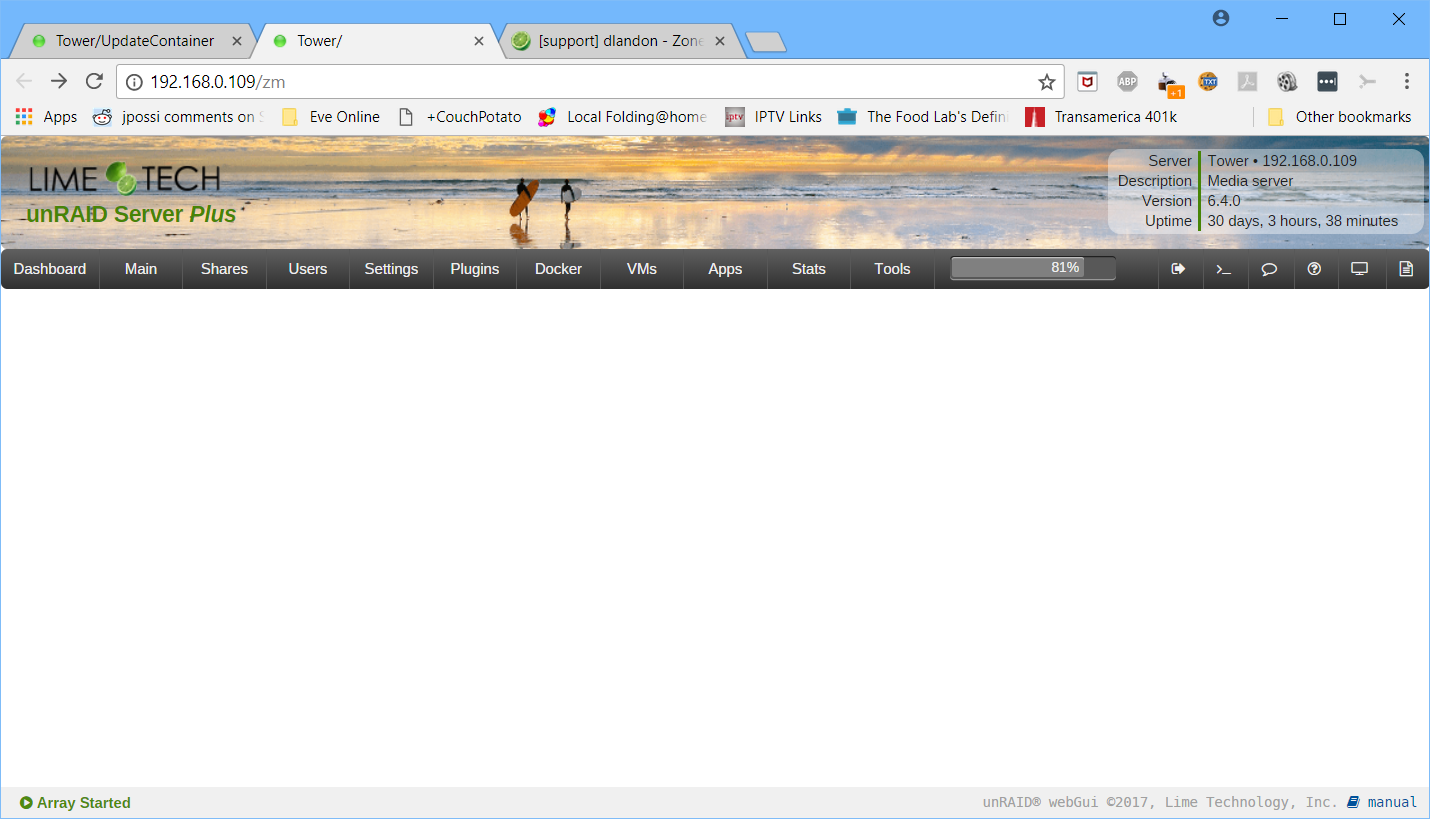

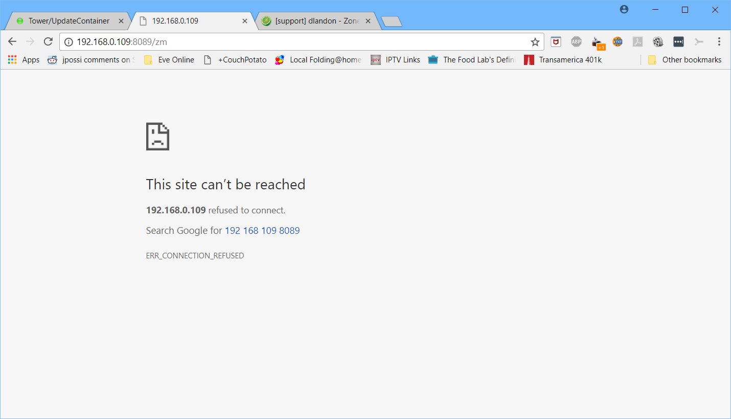

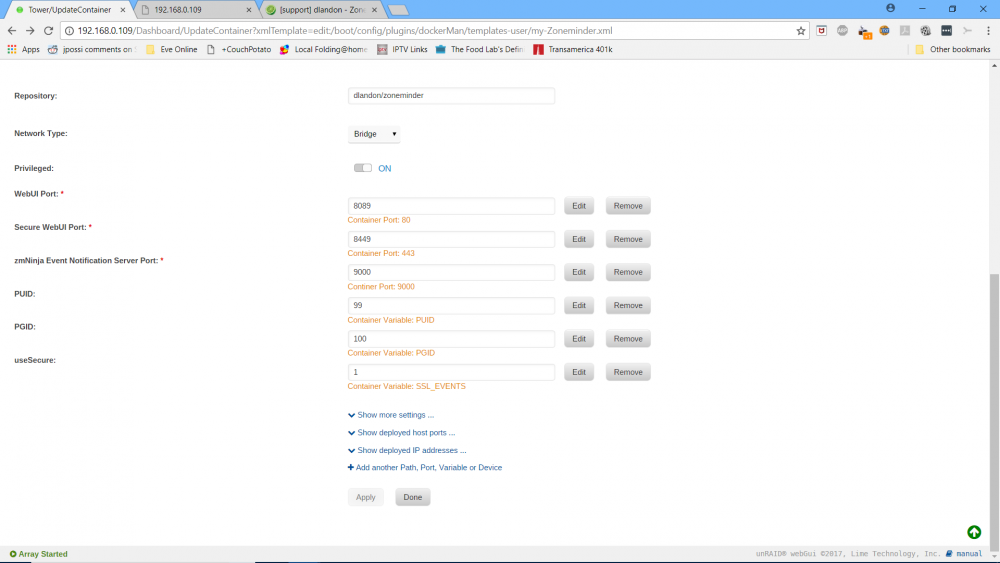

Hi folks.  I'm having a little trouble getting started with this.  The docker starts but when I go to the web UI I only see the Unraid main menu bar.  Manually entering the IP and port just returns a connection refused error.
Any help would be greatly appreciated.

Edited by Waltm
Updated log file after fixing Apache conflict.
