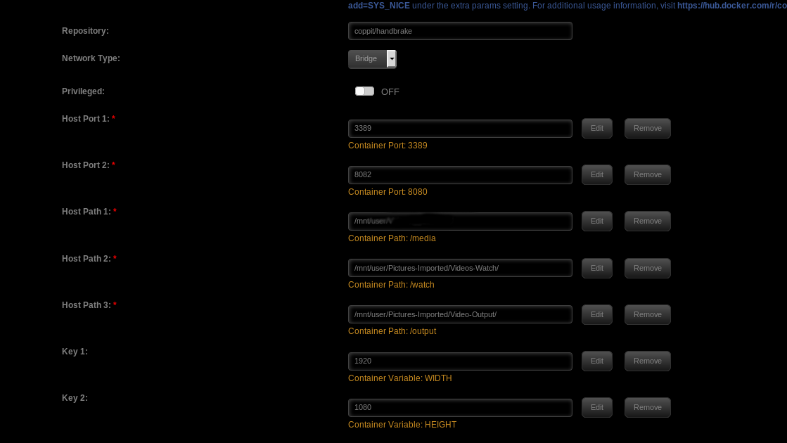

So am I to assume that after it rips a movie from the Watch Folder to the Output Folder it will periodically check for new files in the Watch Folder, but compare to already done files in the Output folder. Basically I have two copies of the same movie, but one is the original that resides in the Watch folder and the converted file in the Output folder.
KewJoe did you setup your WatchFolder location in the Docker Template as well as the Output?
Yes, I definitely did.
Something that is confusing me.
I edited my /cache/appdata/Handbrake/Handbrake.conf to iPad2
I created a iPad2 preset because I want my files to be 1024x768 and now when I run this its not running. I checked my logs and its seeing the file hit the WatchFolder, but its skipping right over the files. I'm dropping files that are at least 1280x720 and it should be working. If its because of the custom preset how can I force the GUI to save any of the presets to 1024 since it keeps wanting to create new ones?
