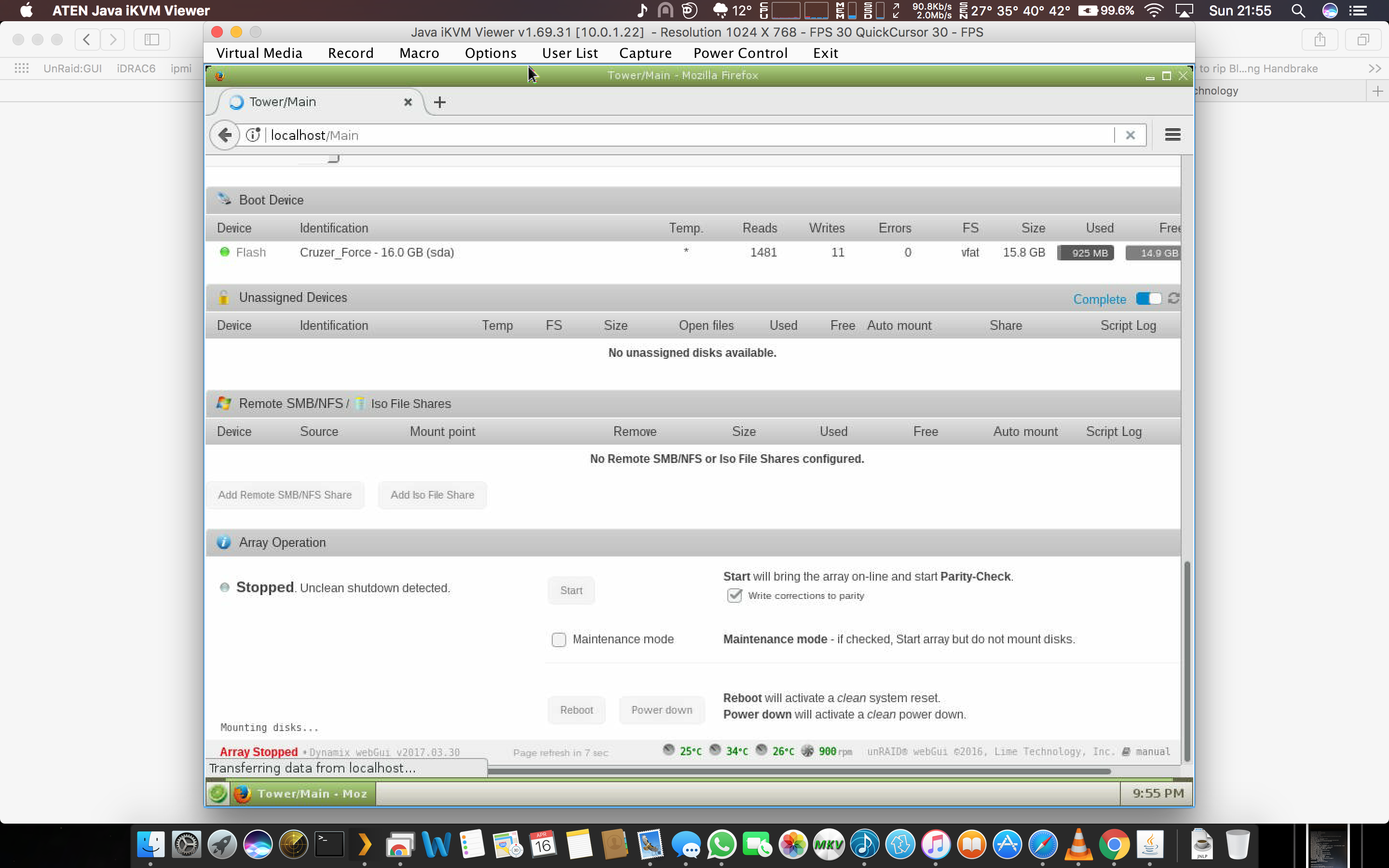

So I gave it a couple of weeks before I updated to 6.3.3 I then checked the forums etc to see if any issues known problems etc and everyone said all is Good, So I have updated and Now I can not get into it. I boot it up into the GUI screen and once I click start I get a spinning wheel on the browser and nothing it hangs. BIOS fully unto date, Nothing has been altered inside the server etc. 2 days now and I still can't get it to Run. Why is there no option to soft shutdown in the OS-GUI? why every time when I update does it Break? I have turned it off via the IPMI countless times iv unplugged it tried safe mode Nothing and I'm getting Tired of it TBH. Please GOD anyone tell me why UnRaid keeps Breaking on UpDate?
Thanks

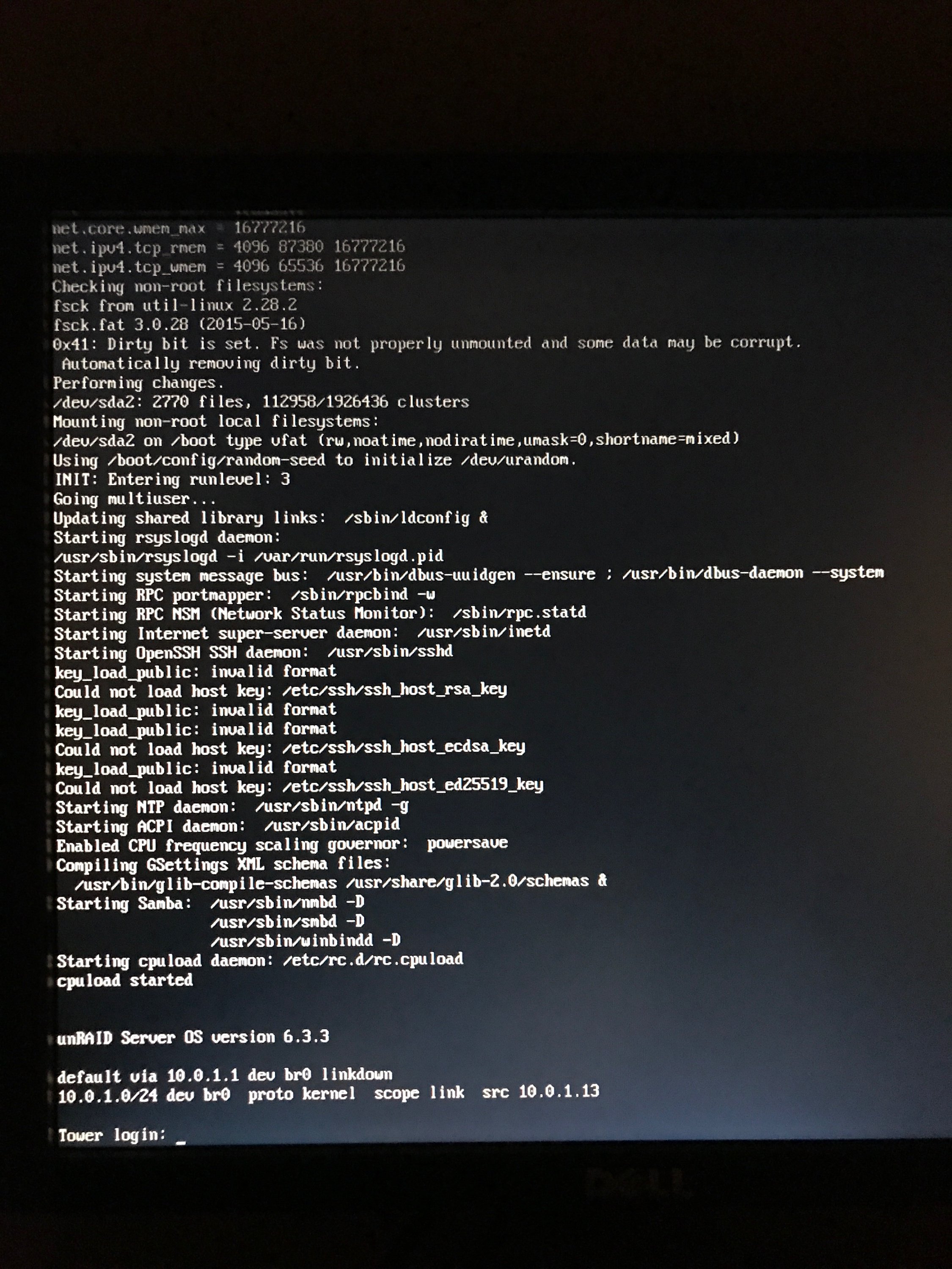

File below is all I have, Second is once I click start I just get the circle spinning while it says Mounting disks :(

No one can help you without the diagnostics.
After starting the array, when the GUI becomes unresponsive, type diagnostics in the console, post the zip.

No but I have to share stuff that I work on via UnRaid to my family all over the world and it then get passed on, I also use it for Plex and Downloading stuff. But why should I be fearful of upgrading the OS why does it Break UnRaid? 3 days down I have to catch up on all that now. Ill attach the Log I have just taken and am going to Restart the server. its a 3 hour drive 240 wish miles to this server so with Fuel etc Yes it costs me money. I have ipmi and VPN to access it but when UnRaid breaks the VPN doesn't work. Sorry in the delay I'm traveling from Spain back to The UK. Im going to stop everything now and stop the array and shut the server down then obviosly re start it and see what it does? but I can't get a log if it freezes when I click Start Array as I have to Physically turn the server off :/

Your first picture shows br0 (eth0) as link down. You'll need to examine that. Cable? Switch? Connector?
There's nothing out of the ordinary on the logs, if it happens again see if the console still works and if yes type diagnostics to save them to the flash drive, then upload those.
