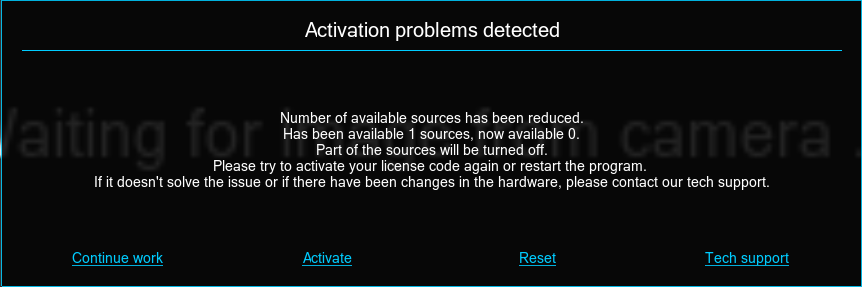

Every time I restart the docker I get activation problem message and have to reactivate to get it working. is there a fix for this?
It's working now. Thanks coppit.

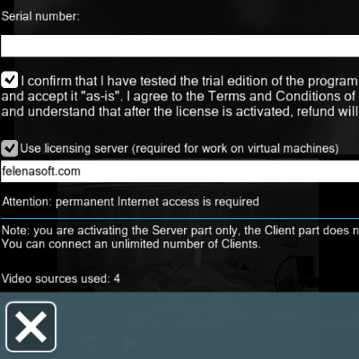

I was wondering if we could have a parameter for the license server added to the docker?  I am having a hell of a time getting that configured.
I setup a raspberry pi running as a license server using these instructions:
https://felenasoft.com/xeoma/en/description/#activation_license_server
I was able to activate the server with my serial number using a commandline argument from the shell:
sudo ./Xeoma.app --activateOnline 'serial number here'
The problem arises when trying to point the docker xeoma at the new license server.
Using Bridge networking I get the right option but UI greys out the box to change to server IP so I can't point the docker to my license server (see image):
Using Host networking mode I don't get the option at all.
The command line arguments allow you to specify a license server:
-licenseServer [LicenseServer]license server for online activation. For example: 192.168.0.1::8090
However, I can't figure out how to insert this command in the docker to specify the license server.
1) Any help appreciated trying to execute the command line licenseServer command in the docker would be appreciated
2) Maybe the licenseServer should be a docker parameter?
ty
i dont thionk thats possible without changes to the docker.
But u dont need that pi, you can use their licence server.
The pi was recommended to use when running xeoma from vm/docker.  That way you can change the docker all you want and it doesn't impact the license.
It looks like the following would need to be modified:
/etc/service/xeomoa/run
add the -licenseServer parameter and server value to the startup:
/usr/bin/xeoma -core -service -log -startdelay 5
