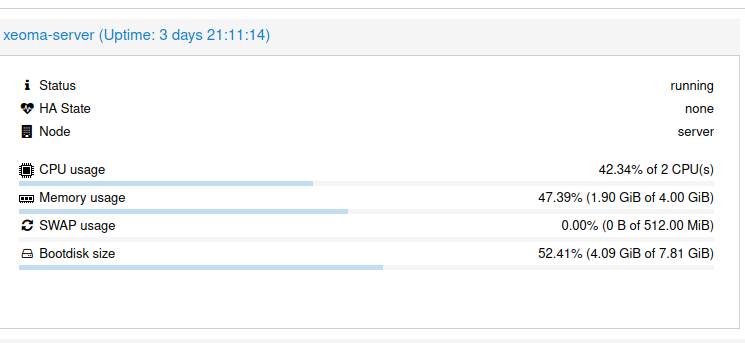

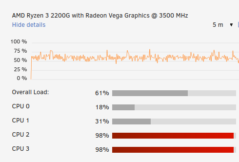

Performance Downgrade with docker | What could it be?.
Before i was running a LXC Container in Proxmox (Ubuntu 20.04), with 2 Cores available:
Average around 40 - 50%
And this is the CPU load with docker, in the same 2 cores:
(Not running other Docker / VM's at the moment)
Average 70 - 98%
The setup of Xeoma and load its exactly the same, as the number of cameras and  configurations didnt change (Using the export setup method).
So.... i find it estrange, i was expecting some changes, but considering that both are running the same APP, in a simillar linux kernel, so having double the load can be right... right?
  • This seems normal?, where should i start to look?
