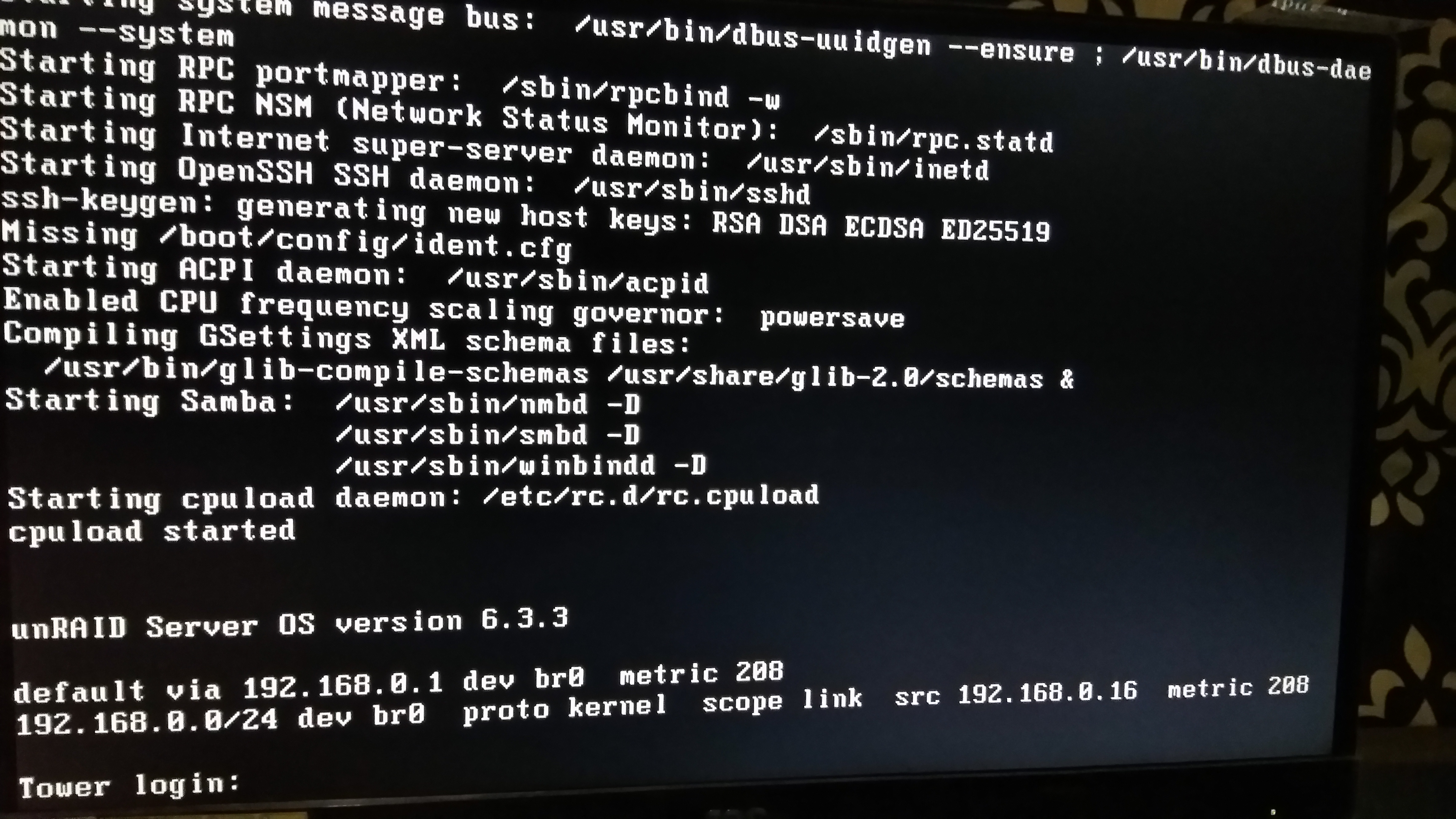

So guys, today i was trying to build my own unraid server but I'm facing some issues with it.
First it is showing that long list of that waiting for dev disk label "UNRAID" thingy and then I'm stuck with this screen.
I have tried two different pendrives, both are giving me same issue.
So if anyone know how to fix this then please help me.

That screen is perfectly normal.  Normally you access the GUI via a browser (go to http://tower or http//192.168.0.16).  To access via the local monitor, you have to boot into GUI mode (option on the boot menu)

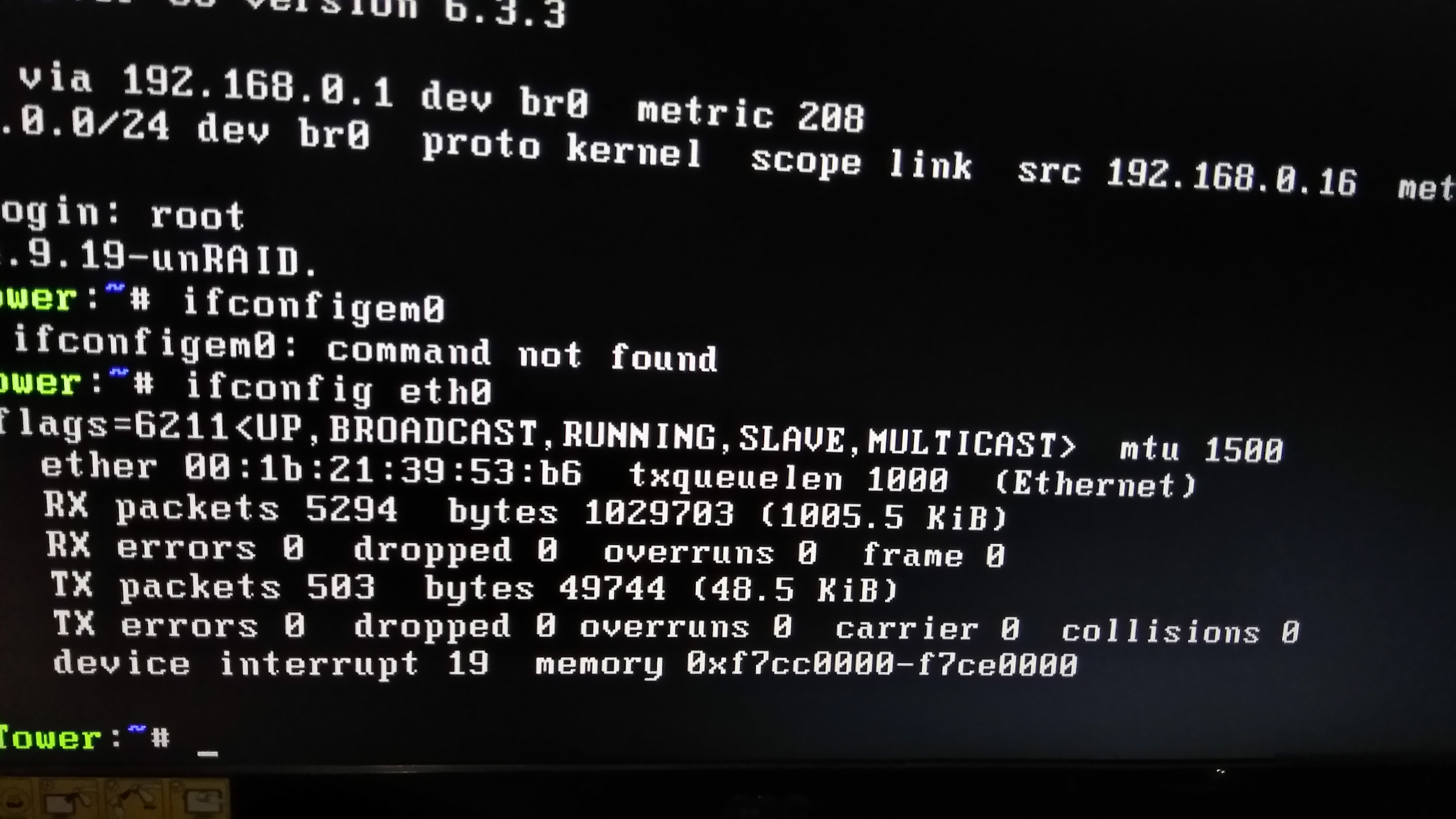

What does ifconfig say?

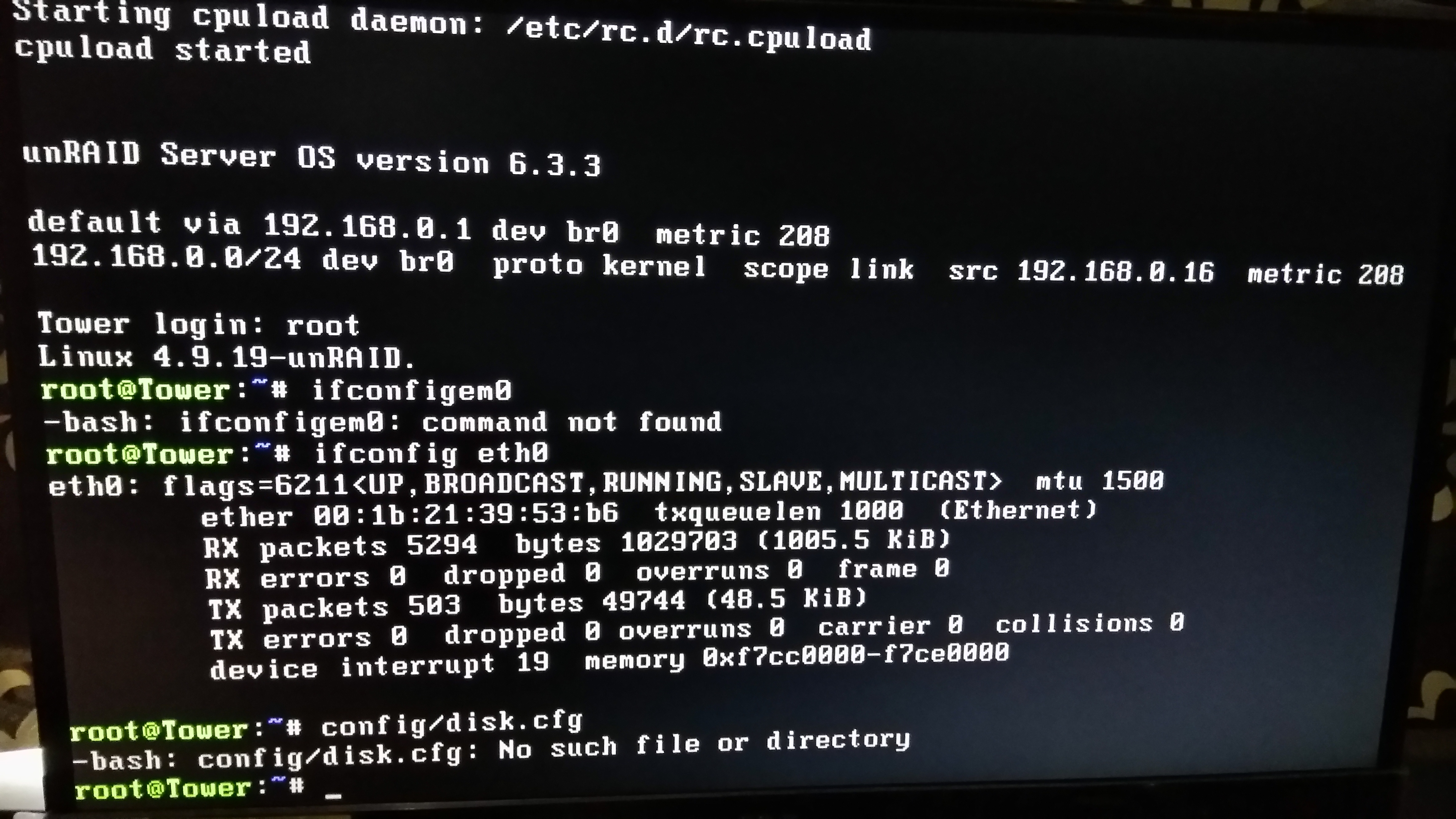

The only time I've been unable to get to the gui is when my array wouldnt start, but yours shouldnt be on since its a new install, either way you can check your flash drive (config/disk.cfg) and changing startArray="yes" to "no".

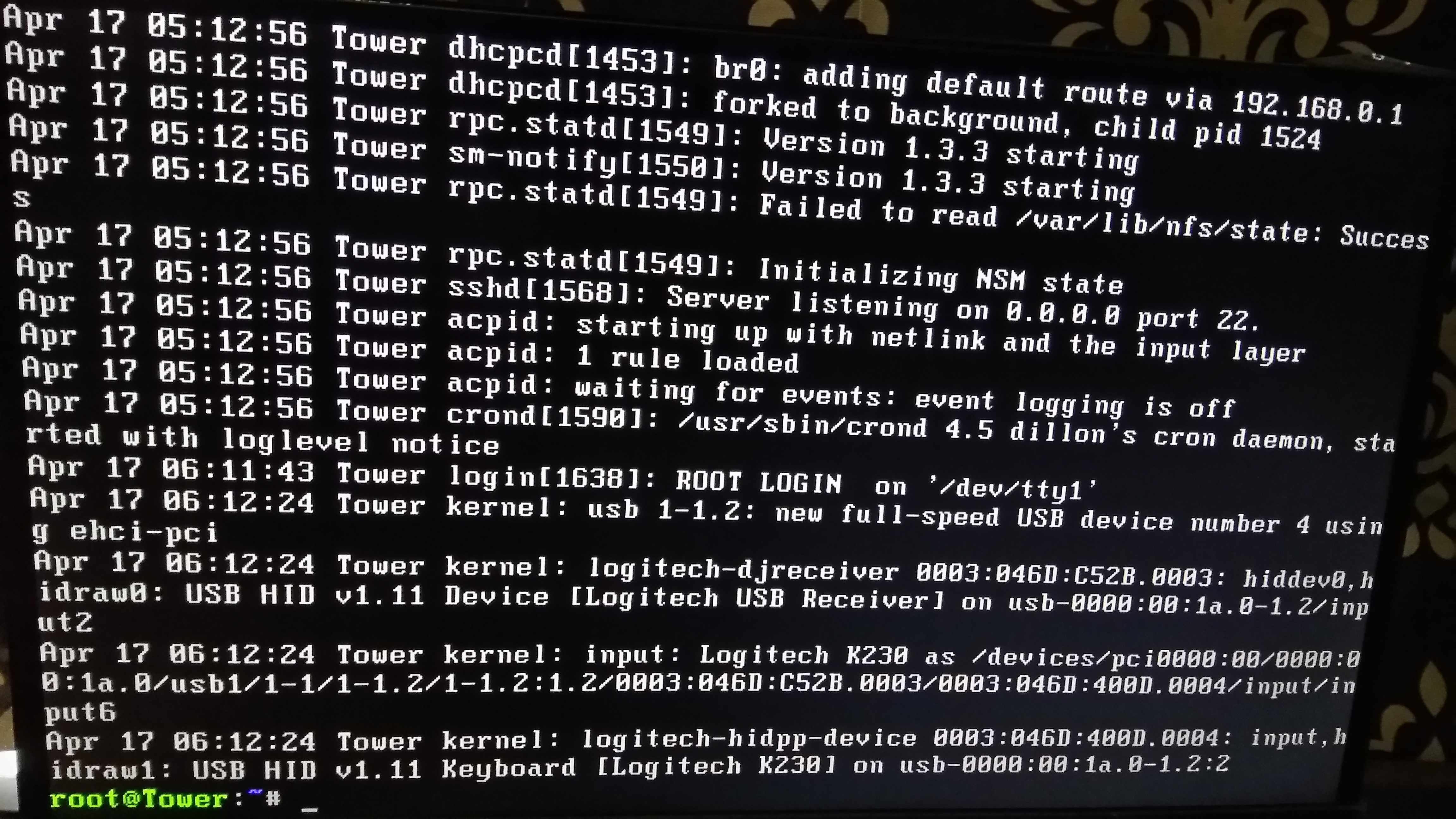

also check
cat /var/log/syslog

Their you go everything in pics.

looks all normal lol, maybe try a different usb formatted to fat32
