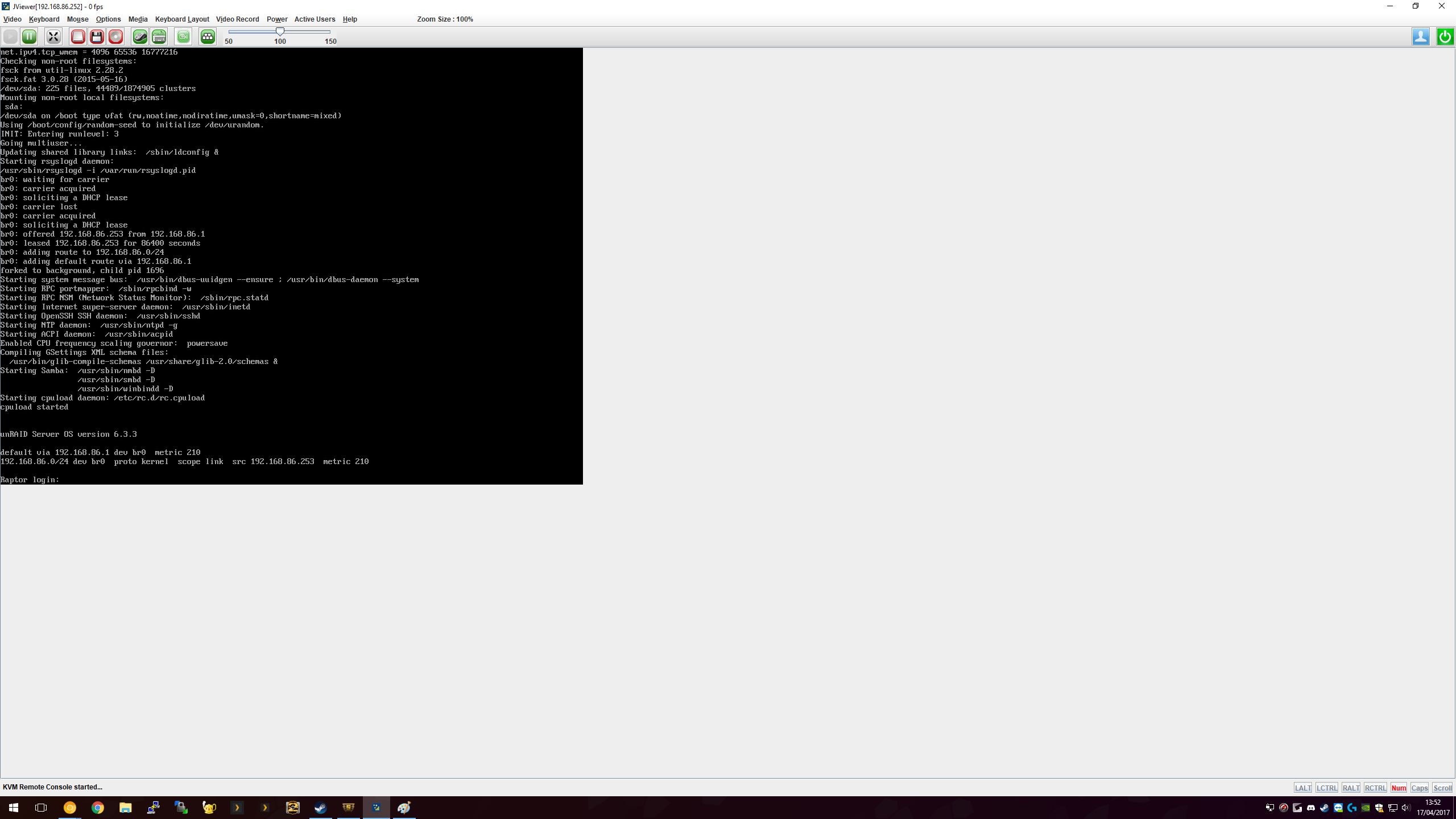

So, when the system was in this state (happened several times now) I'd better install the Fix Common Issues plugin tbh... Anyway, when in this state, the WebUI was unreachable from anything, networking is just gone, i.e. even my router can't see the server, it's as if it was unplugged (it ofc wasn't, link lights etc.)
I have IPMI so I can get to the local console, the diagnostics command hung for 20 mins before I finally pulled the syslog and did a reboot.
Any commands like "ip a" or "ifconfig" they also hung the terminal. Even CTRL+C didn't help, I had to switch through my ALT+F1, 2, 3, 4 terminals haha

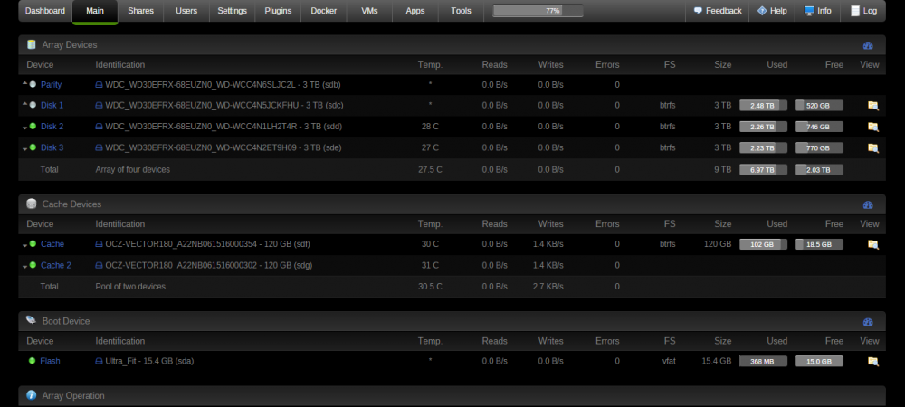

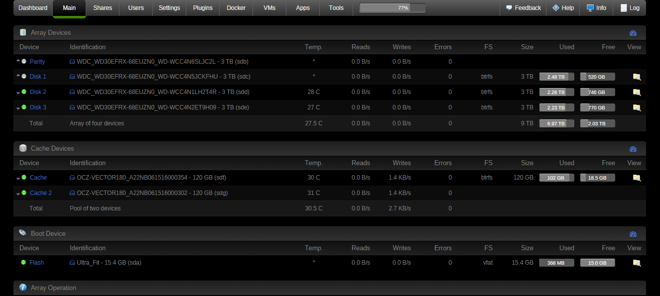

My array doesn't look full to me? Not sure what gave you that impression? :)
What's the next step here?
19 minutes ago, limetech said:
Apr 24 18:03:18 Raptor shfs/user: share cache full
Aha... I see, that's just the 85% limit I believe, normally sends me an email once that threshold it reached (and that message shows up in syslog) :)
Not full full afaik

I've got no networking access, webUI isn't reachable, nor is SSH. I have local access via IPMI. I run the command
diagnostics
and all I get is "Starting diagnostics collection... _
It hangs there for a seemingly endless amount of time. I'll leave it on this screen for a while but whenever I've run it in the past, it's never taken this long!
Surely there's a pretty big problem somewhere in unRAID if a share thinking it's full results in an almost full system crash... Basically lost my array and networking - Any attempt to access /mnt/* just hangs.
/boot/* is the only directory I can work in and actually save log files to.
