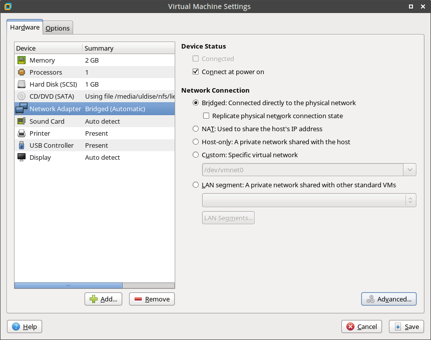

i'm using bridged network, see picture,
On 4/18/2017 at 5:06 PM, uldise said:
No, network is not related to plopKExec at all..
Tried removing all other virtualization software and reinstalling VMware, it just worked with no eth0 error after that. Thanks for you assistance!

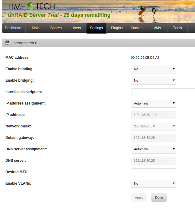

Don't know, sounds odd.. I just tried myself again, can access web interface form Host machine, and from another Win10 VM too..
Edit: look at my unRAID network settings, i disabled some things..
