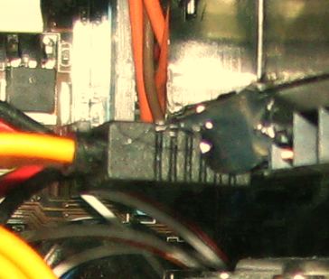

About the errors on disk1.  I may have mentioned that I have a disk where the cable latch part is stripped on one of the catches and even the drive vibration seemed to make it wonky.  I used a small bit of hot glue to stick the cable on and it fixed it immediately.

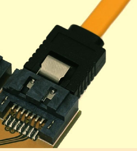

For mine, it wasn't the cable at fault.  It was the socket on the drive.  There are two small square indentions inside the socket where the cable latch nubs fit when you push in the cable.  On mine, the latch nub was only latching on one side.  The other side is stripped out.  No cable will ever latch on that drive so hot glue was the answer.  Some times it's the little things that cause the big problems.
Good suggestion queeg, though does it hold if the SATA cable is accidentally moved or knocked slightly? Personally I wouldn't leave that for long-term use, though I would use it as a method to get the data off the disk, get a replacement and I'd change the disks asap.
It's really solid now and it would take a lot more than a slight knock for the hot glue to come loose.  It's simple to remove the glue with a screw driver or something that can get under it and peel it up.  But I could pretty sure I could dangle the drive from the cable without it coming off or even wiggling.
Yeah it is good thing to know queeg. I would of used a dab of silicon to do this kind of trick, but it takes a lot longer to dry and albeit not as strong too.
