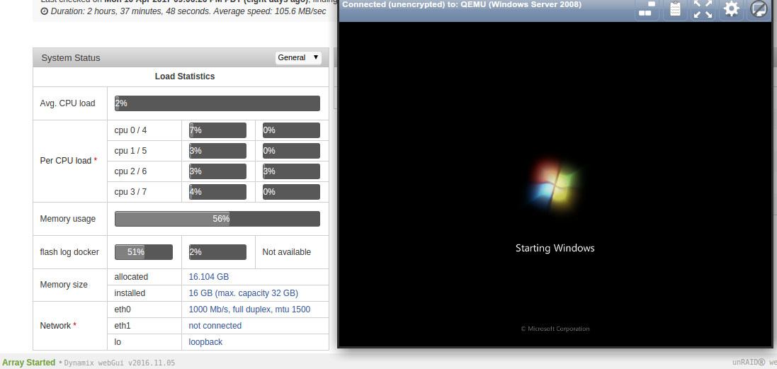

When booting up the ISO to start installing, the VM gets as far as the loading logo and doesn't shift from there - no resources are under heavy load and it will sit there for hours.

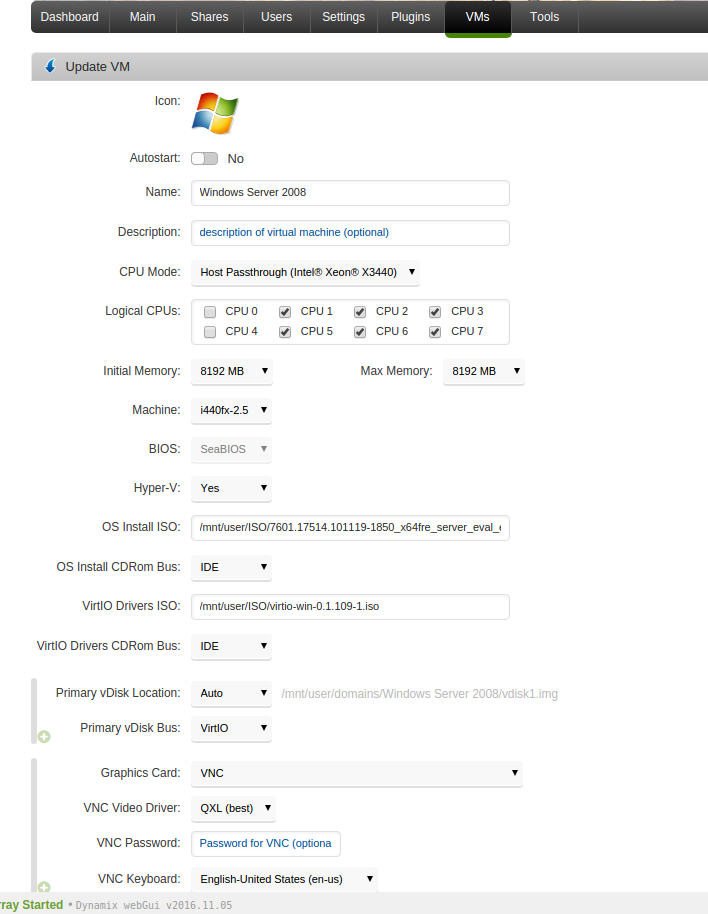

I have checked that the ISO works, and I have checked all my BIOS and VM settings, all seems to be setup correctly (from what I can tell). Have tried with both SeaBIOS and OVMF, and both i440fx and Q35 types. All combinations will freeze at exactly the same point. Current configuration shown in attachment.
try installing with 1 cpu assigned only. once it's done, increase to more cpus.
that issue occurs across several windows products and even on updates.
Tried it with only CPU0 set. It has been on the attached screen for 10 minutes now...not promising.
From past experience, it should get to the install screen in 5 minutes or less...correct me if this is not right now.
Thank you so much 1812 and jonathanm!
I'm not sure if it's the change to Cirrus or the combination, but it is now working.
