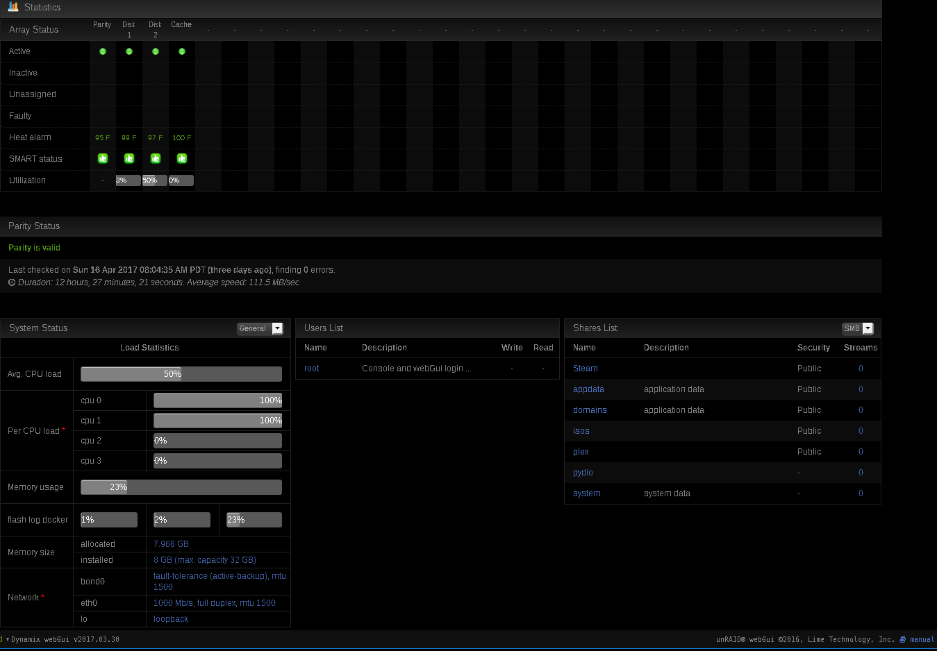

Attached you will see my specs and an example of my cpu load any time I have anything running on plex. It seems like a phenom 2x4 840 would be powerful enough for this application. Im not sure if unraid keeps any configuration between computers, but this particular installation/usb was previously on a computer with similar specs, but a high end fx processor. Since then I've moved it to my media server and have been working to get all the functionality from that server working with unraid. Anyway, thats the history, if it matters.
The problem here is that the plex docker (linuxserver's repo) and indeed the entire system seem to be only using the first 2 cores of the processor. I have no vm's and unraid is not running as a vm itself, so there should be no reason for it to not use the entire cpu... unless this is a limitation of unraid, which would make me sad.

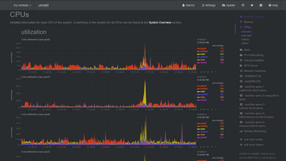

I would load and run a docker netdata.  With this docker you can parse out the resources each docker is consuming.  I have two dockers running currently, \ The docker the hostnames are unconventional.  Mine are 009b8df5731b and dad2090c2f4c
Running the Web UI for netdata you can see exactly the resources each VM is consuming.  I would validate what your seeing on the unraid dashboard CPU metrics with what unraid is stating on the dashboard page.

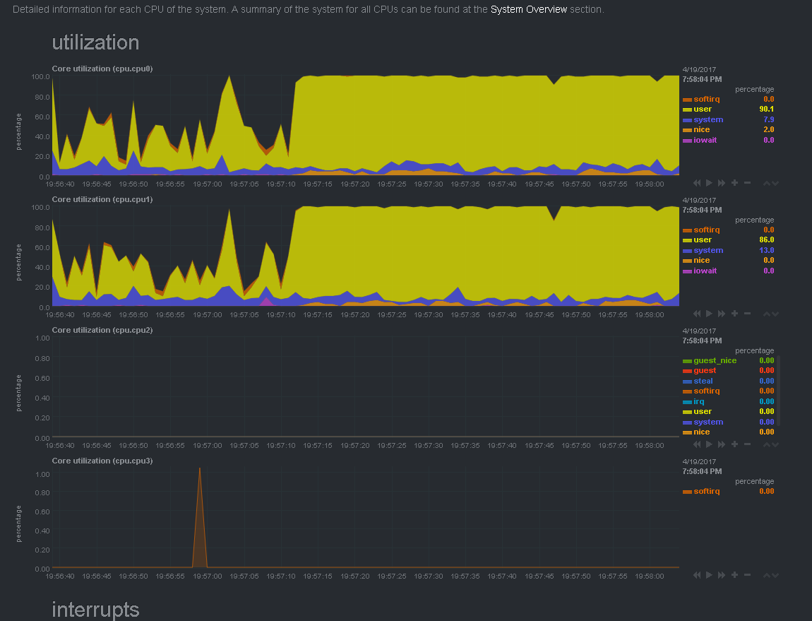

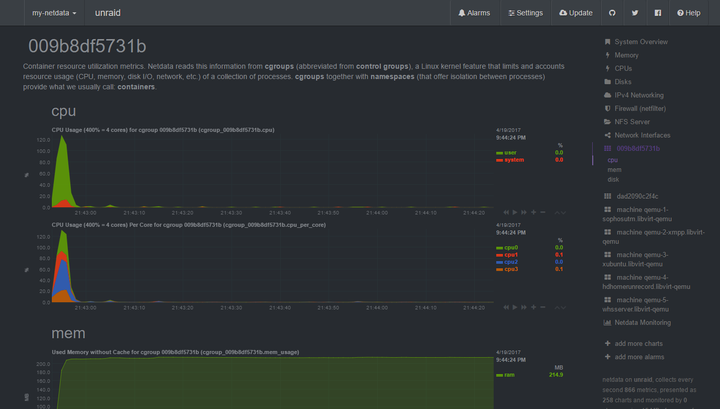

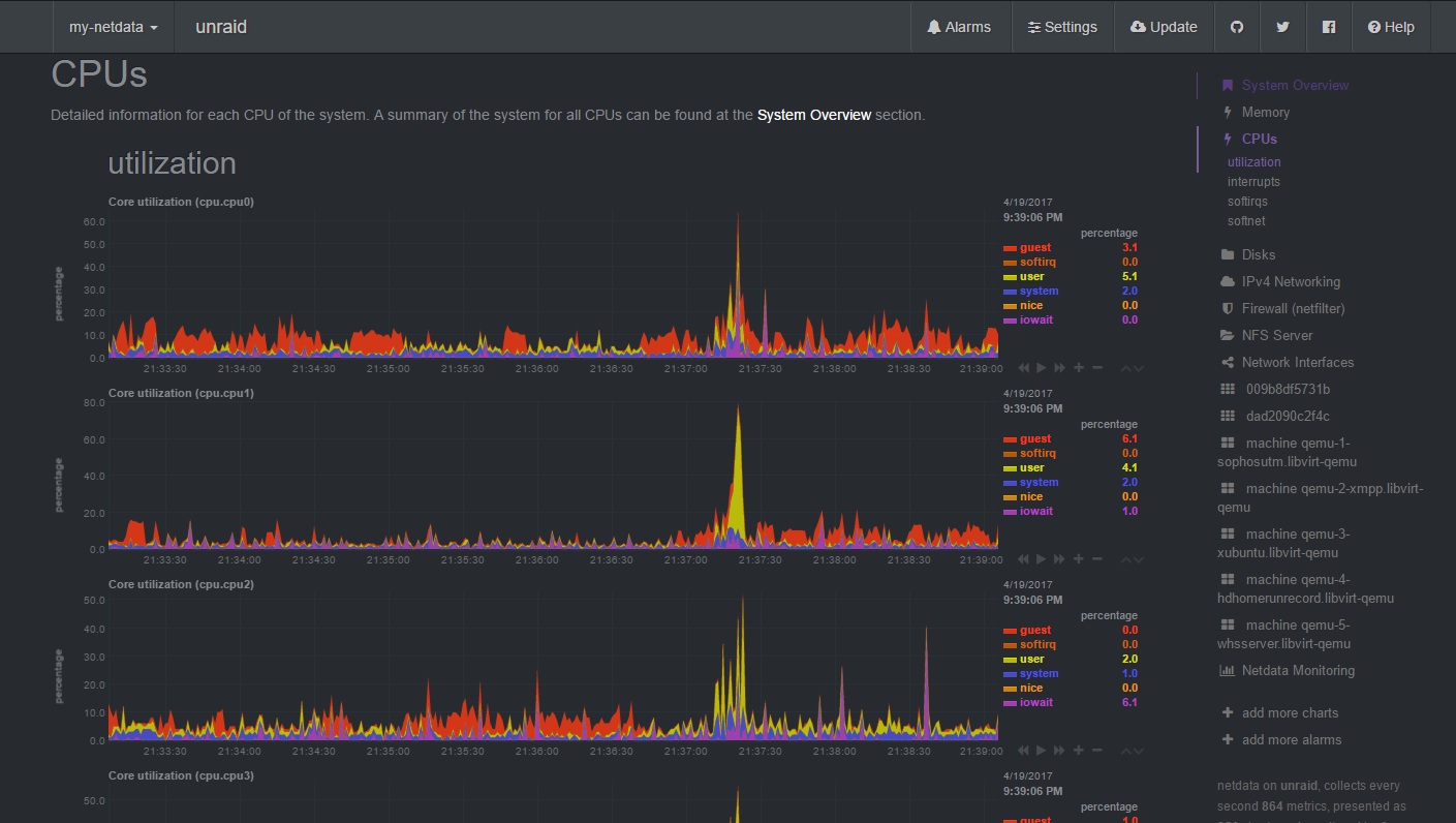

Here's the breakdown of CPU core utilization and the individual plex docker CPU resource requirement upon a fresh start of the docker using netdata
Edited by joedotmac

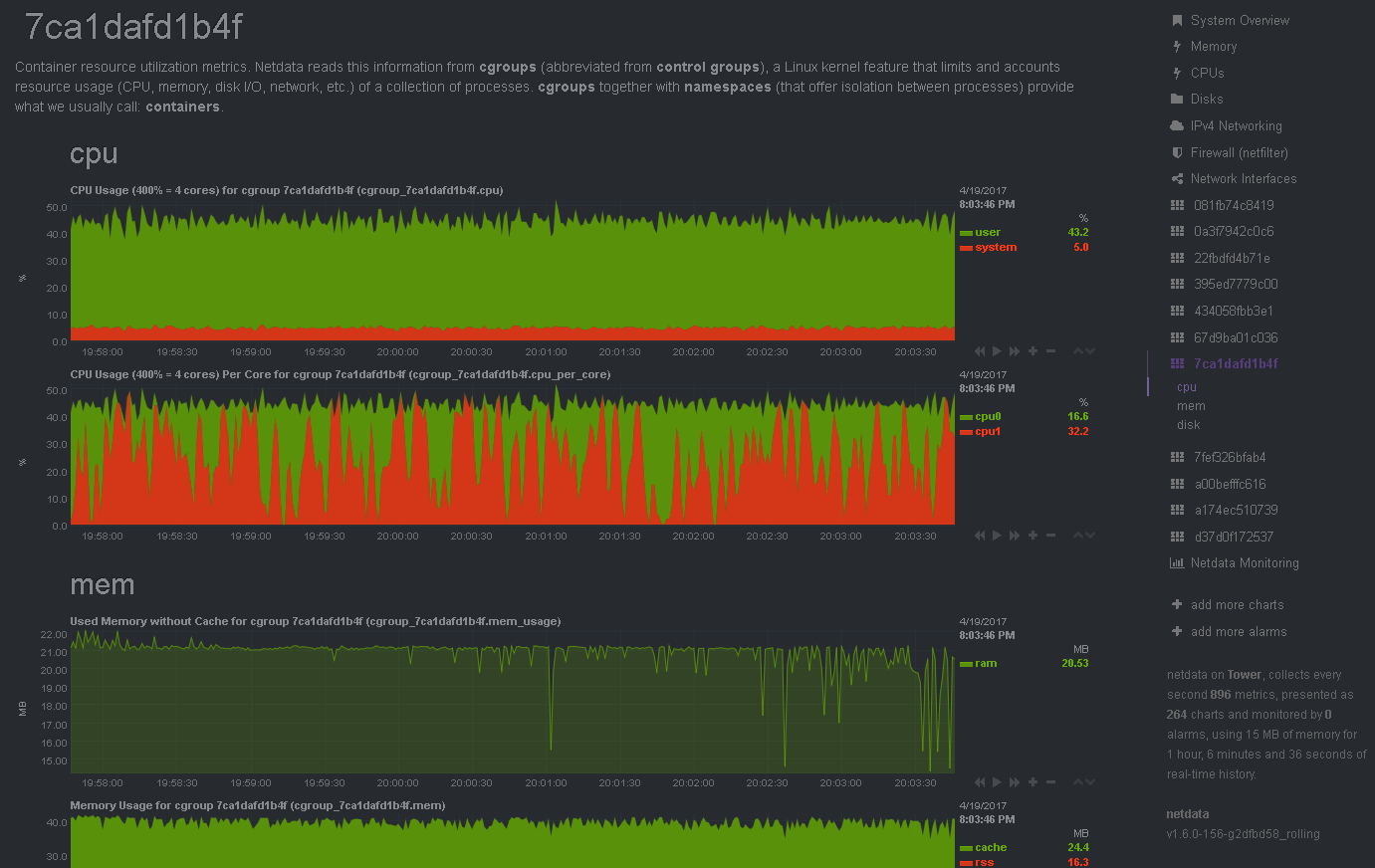

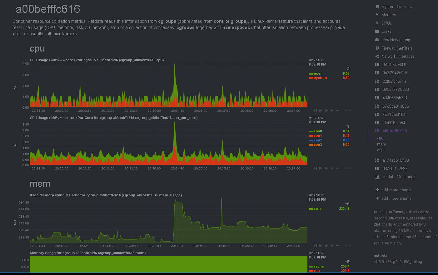

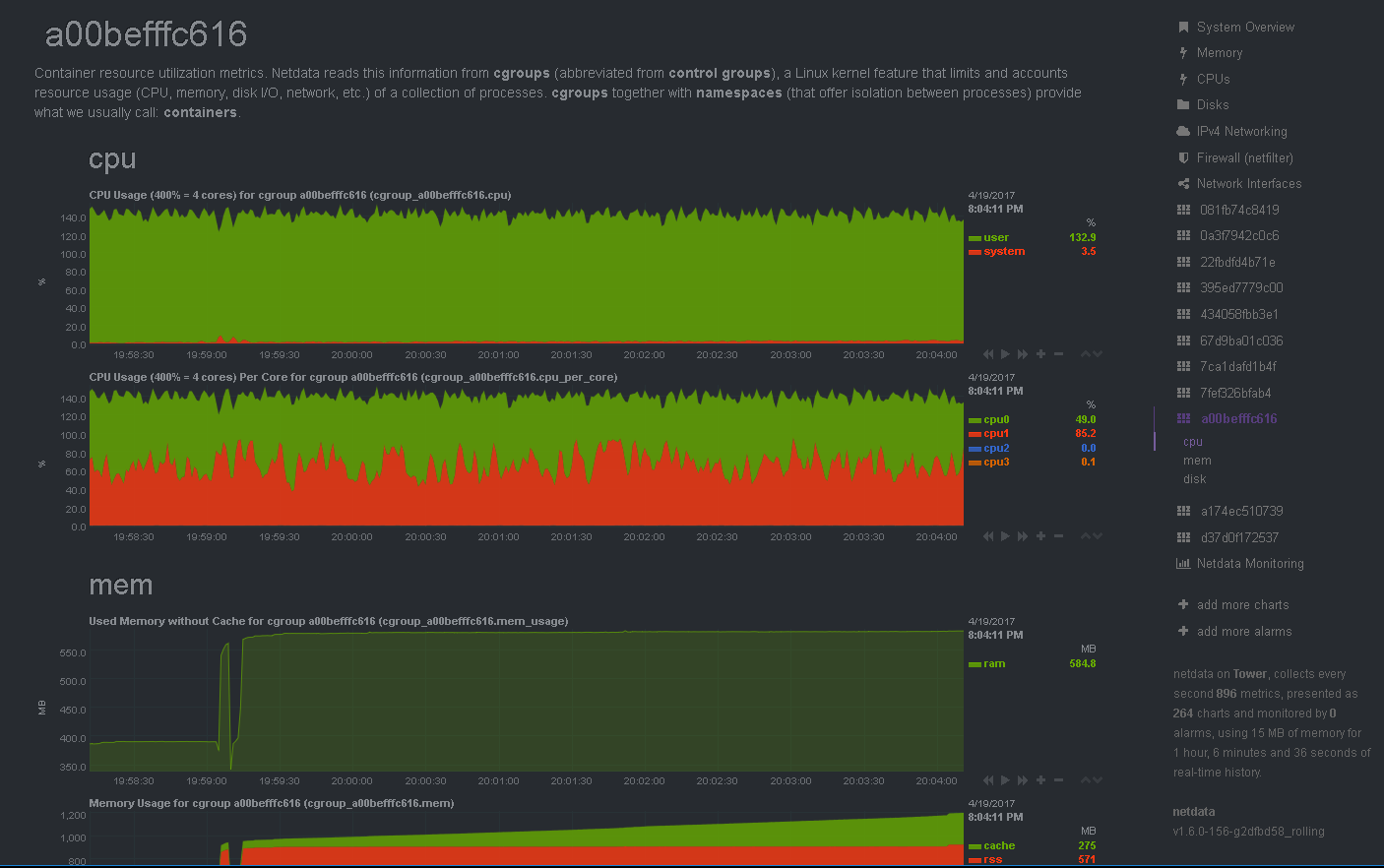

Thank you for showing me that docker, very usefull troubleshooting tool. Unfortunately, if I'm reading this right, all I'm confirming is that it is indeed only using 2 cores. All the mac addresses I selected and screenshotted are mostly at 0 with a few little spikes, I don't know why I have 2 of them using cpu, I only have plex working on anything.
Im pretty sure a00beffc616 is plex.
Note that screenshot 1 is overall CPU utilization shortly after playing a 1080p movie with no subtitles, original quality and original sound playing through a different computer on firefox, sorry I chopped the nav bar off on that screenshot.

Does the docker ever release the CPU or does it maintain that utilization level for hours?  Mine sometimes when I start it consumes a considerable amount of CPU for two to three minutes.  I believe it's Plex attempting to update library meta data.
If your unsure which is Plex, stop Plex and watch which docker instance stops producing data into the graph.  I had to do the same.
It would appear one docker is using 45% and the other, likely Plex is using 145% of a total 400% compute available.

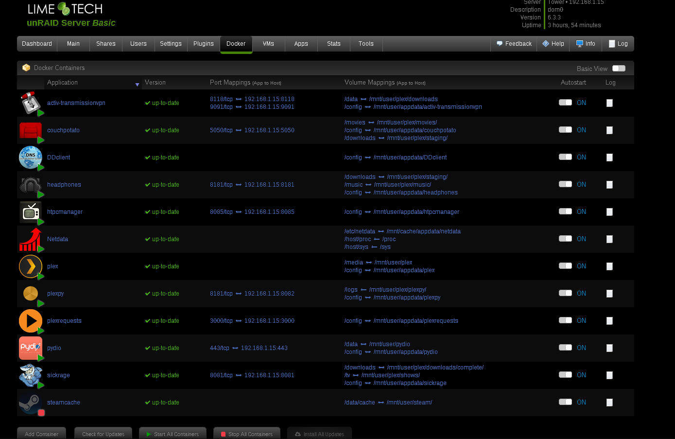

None of your other dockers exhibit this behavior?  I'm using binhex-plex FWIW, it's updated quite frequent. Not certain if anything points to the docker itself, but worth a mention.
Ill try out the binhex repo later tonight. Ive confirmed that a00beffc616 is plex and attached is that docker idleing. Also attached is my list of installed dockers, mostly low demand python stuff, but the main problem is my suspicion that only 2 cores are being used by plex in the first place. I understand that plex is the vast majority of processing requirement, but I was running pretty much this same config on steamos (debian fork if you didnt know) and had much better performance.
