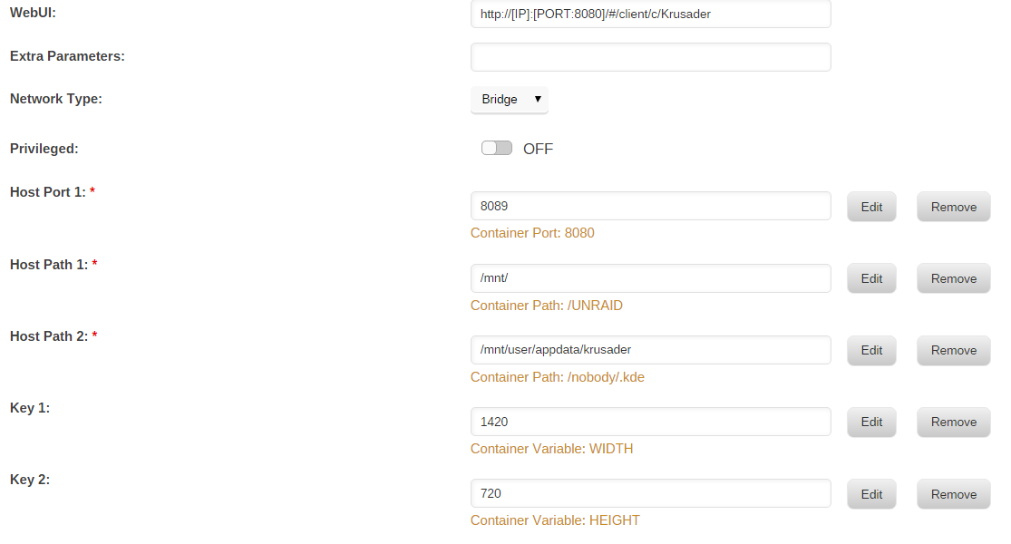

Easiest solution would be to install and set up the Krusader app, then navigate to /UNRAID/user on both display panes, then cut and paste from one to the other to combine the files all into the same share.  Then double check your mappings in your various docker apps and make sure they are all using the same one (otherwise it will just get created again)
Set up Krusader something like this:Untitled.thumb.png.cfacf77e186986869e38d60b716a89cb.png

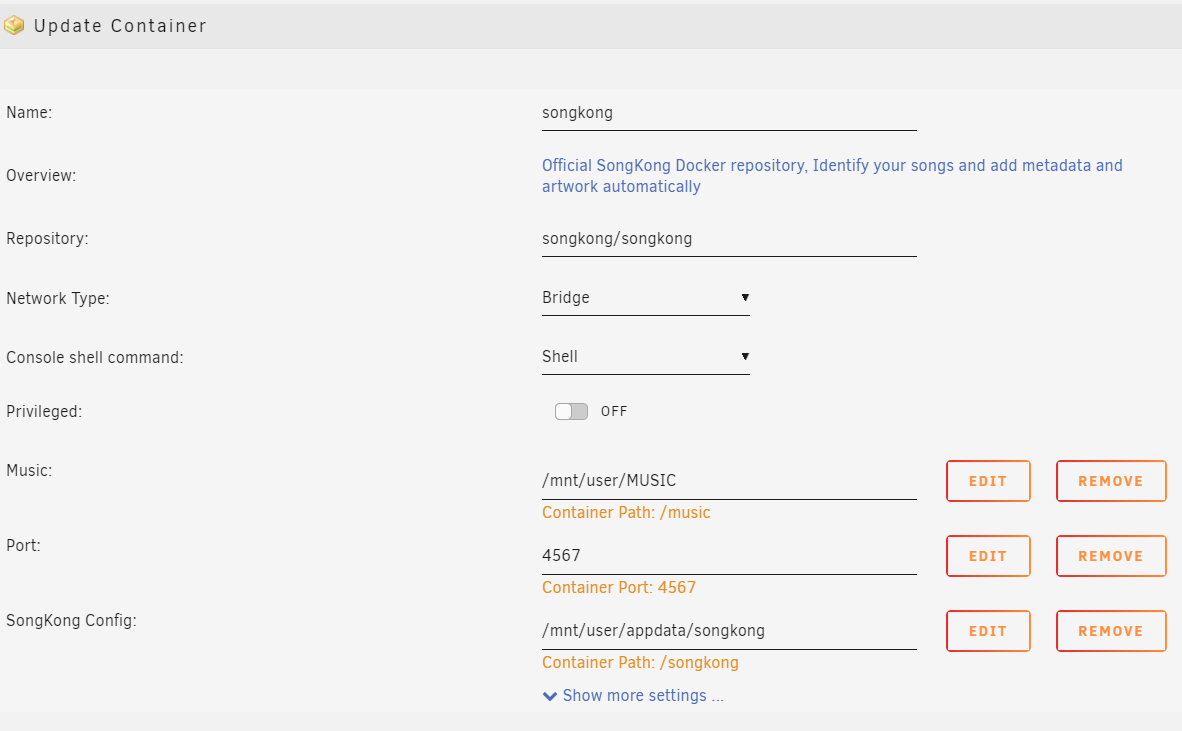

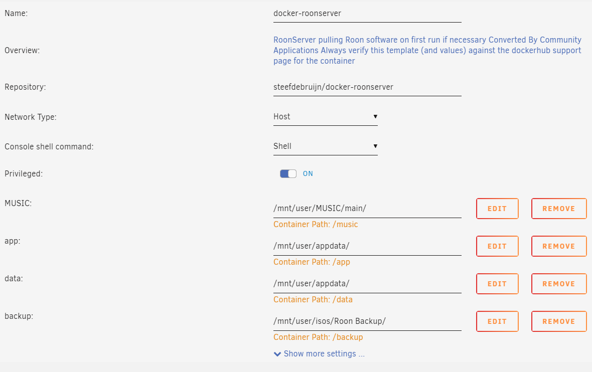

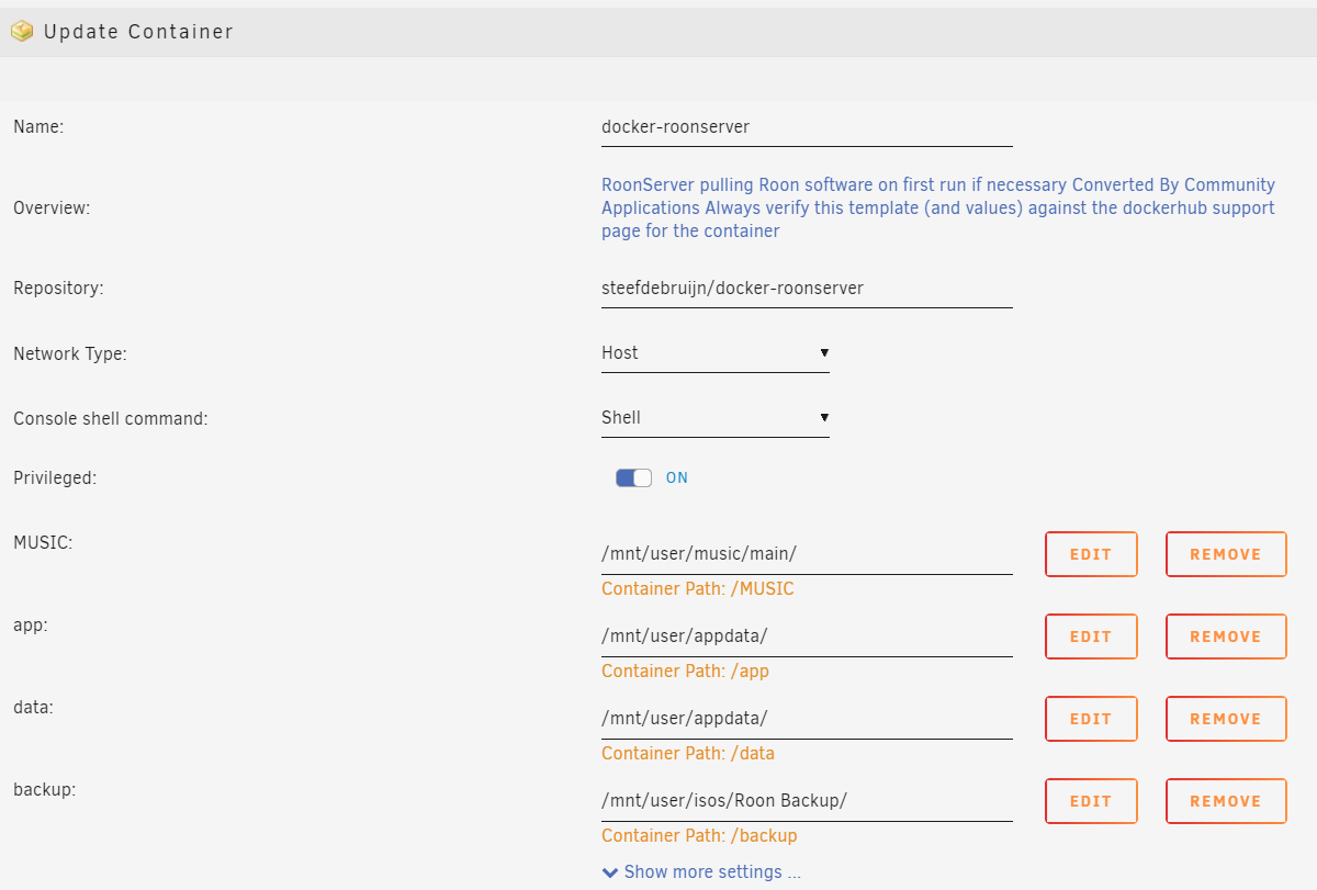

I originally tried to have my main folders in CAPS, so just now, I tried to change the docker "roon server" mapping to caps as shown here:
and the docker for "songkong" was already set to caps as shown here:
but it did not work.  After rebooting my unraid array, the lower case came back.  I only have 2 other dockers and they do not reference music in any capitalizaton at all.  What did I do wrong?  Should I give up on having upper case?
do i have it backwards, the orange text should not be my unraid path/map?  Should I change the black text to caps, and change the orange text back to lower case?
Now I see from songkong, I need to change the black text to caps.  I will try that.

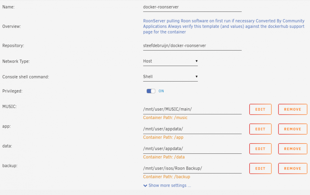

I could not see the lower case "music" unless I used Krusader.  I don't know how to see it from unraid.  I clicked on the folder icon to the far right.
5 min later:  I think it worked now using CAPS.  No error in "check common problems".  Here is my roons server config:
