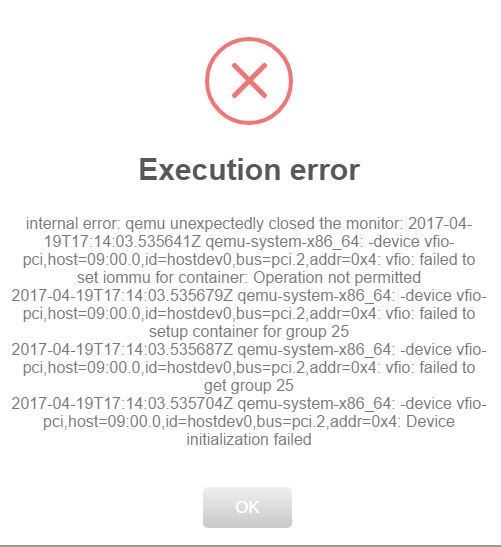

I was running unRAID under ESXi for years with a Windows VM with a AMD 6450 pass through.  Now that unraid supports being a hyper-visor, I would like to use it has the host OS.  I did all the prerequisites, but get the dreaded "Execution Error" when trying to pass through my video card.  I have an old VGA card for unraid. My 6450 is in group 25 as noted below.  I also tried adding this to my config: " append iommu=pt vfio-pci.ids=1002:6779,1002:aa989 initrd=/bzroot".  I tried PCIe ACS Override: off and on.  I moved the card to a different slot.  But no matter what I try the VM will not start if I add the 6450 and sound that goes with it.

2017-04-19T17:17:55.762864Z qemu-system-x86_64: -device vfio-pci,host=09:00.0,id=hostdev0,bus=pci.2,addr=0x4: vfio: failed to set iommu for container: Operation not permitted
2017-04-19T17:17:55.762905Z qemu-system-x86_64: -device vfio-pci,host=09:00.0,id=hostdev0,bus=pci.2,addr=0x4: vfio: failed to setup container for group 25
2017-04-19T17:17:55.762910Z qemu-system-x86_64: -device vfio-pci,host=09:00.0,id=hostdev0,bus=pci.2,addr=0x4: vfio: failed to get group 25
2017-04-19T17:17:55.762921Z qemu-system-x86_64: -device vfio-pci,host=09:00.0,id=hostdev0,bus=pci.2,addr=0x4: Device initialization failed
