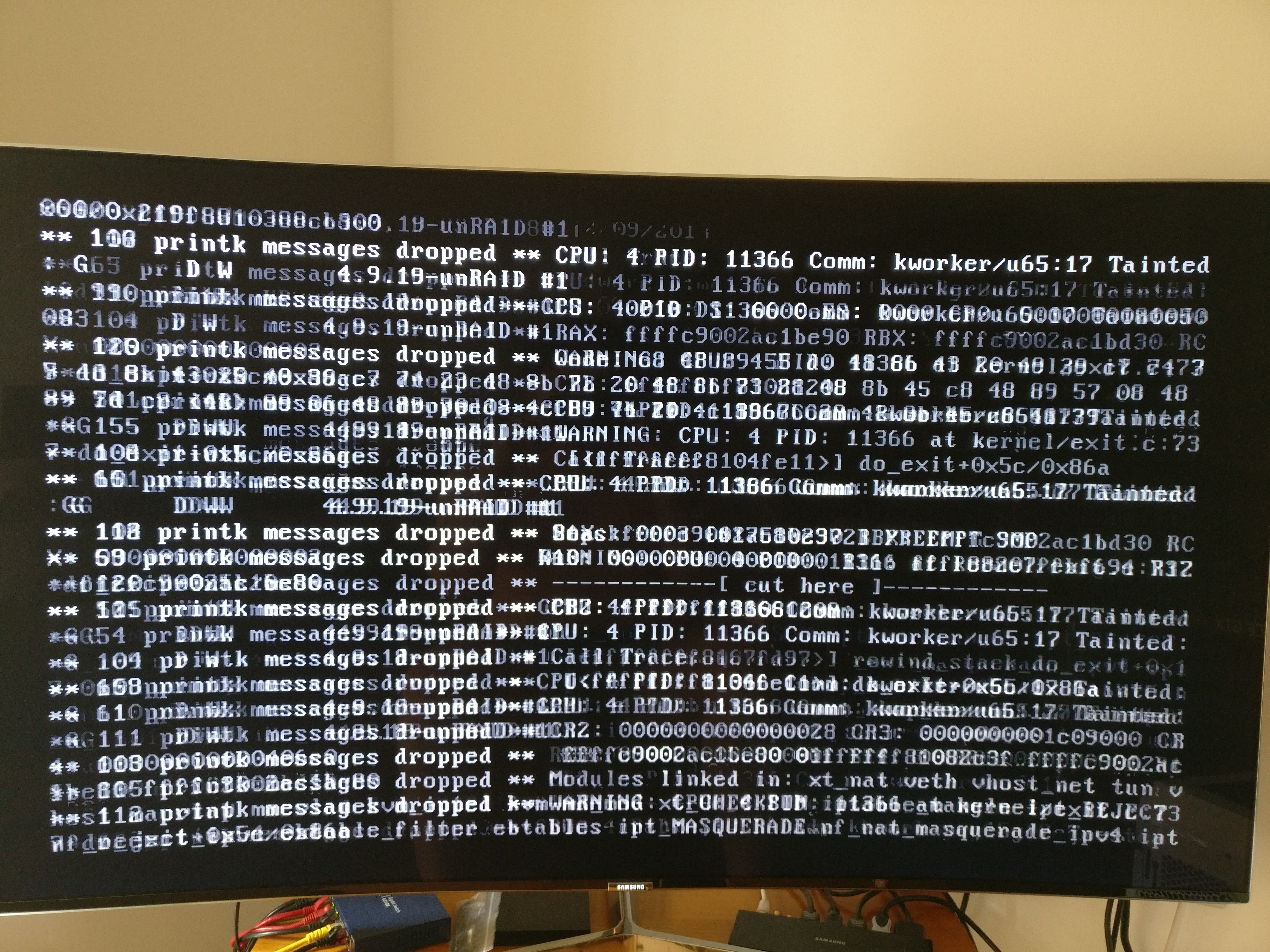

System Hangs completely and is unrecoverable except for hard reset.
Viewing the logs it looks like I have disk issues. Unfortunately, two of the disks are very old, but they were all I had at the time. One disk (I believe it is ata7 in the FCP_Syslog) is brand new.
When the system hangs, the hard drive indicator light is stuck on, the system loses all network connectivity (except IMPI, which is handled by the BMC chip), and is unresponsive to local commands. The local monitor also scrolls too fast to read with "XXX printk messages dropped".
I unplugged the sata and power cables and replugged them in all the drives, however, this only occurs when the mover is running overnight. I've left FCP in troubleshooting mode on a few occassions and attached the logs that actually had data, and and image of the local monitor scrolling.
Are my disks just too old to use, or could it be something more sinister with the motherboard?

The disks look OK, except for 2 reallocations on parity. Probably a connection or controller issue. Since you don't have many disks, you could try connecting them all to the intel ports and not the marvell ports if they aren't already.

The cache and parity disks are attached to the onboard controller, the other two are connected via the marvell chip. Due to the restrictions in the case, it'd be a bit of a pain to move them over to the other intel SCU connectors on the board, but it could be done. Is the marvell chip known to cause issues?
There have been some reports of issues with some marvell on some configurations. Don't know if it's really the problem here or not.
The Marvell ports (4 first white ports) on those Asrock boards are known to be very problematic and drop disks, never use them.

Ah okay, I need to rebuild my array now because disk 1 has the red x next to it. I'm assuming that if I move the disks across to different SATA ports, I'll lose all my data, unless I have a fully working array and move them one at a time with a rebuild between disk moves?
You can shutdown and swap ports, it won't affect your data or the ability to rebuild the disabled disk.
Okay thanks, I'll have a go when I get access to the PC later tonight.
Switching the SATA ports has led to a stable configuration, at least for the last two days. Does anyone know what the issue with those Marvell controllers is, and if it will be fixed?
