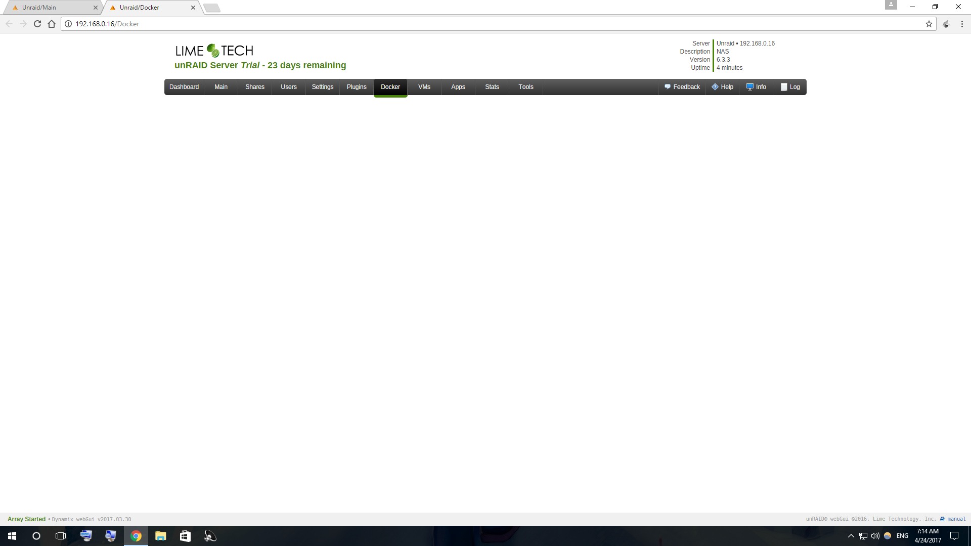

Okay so this is how the docker page loading up now after hard rebooting and starting unraid array.Capture.thumb.PNG.c00333427f6e5ee7fe67941ee45472be.PNG

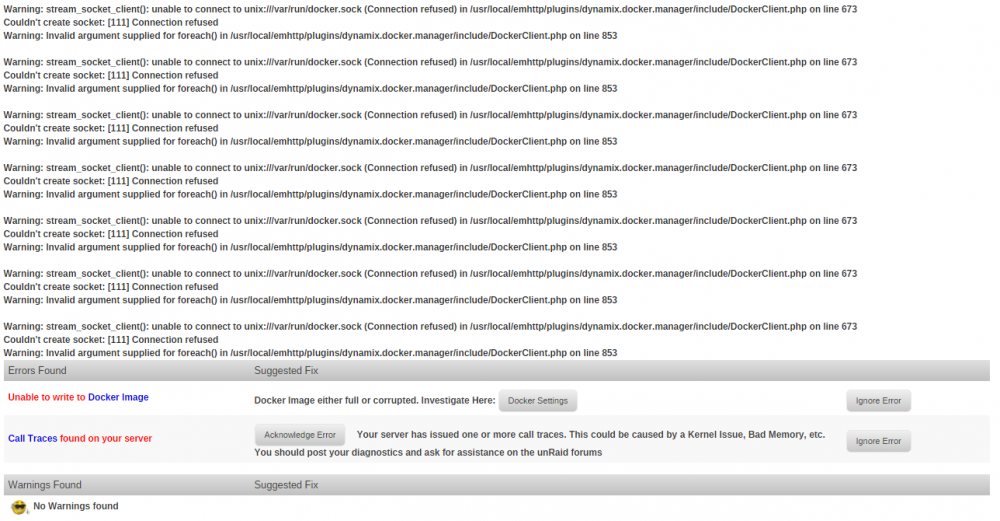

after that i tried to look for errors with the help of fix common problem plugin and the result is down below--

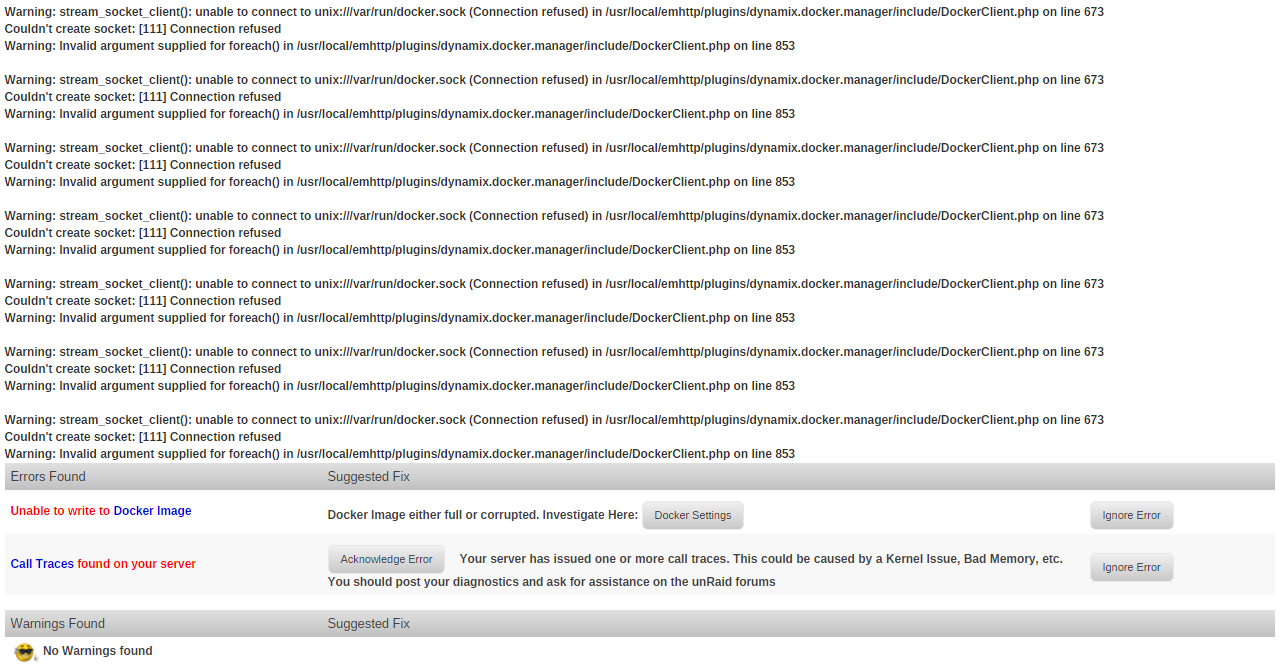

 i tried increasing the size of docker image thinking that this might fix the docker part of errors but after increasing size of docker image i did a hard reboot but still nothing has changed except that fix common problem plugin didn't find any errors this time but the docker problem is still the same, dockers are still missing and docker page is still not loading  properly.

Docker image is corrupt, delete and recreate.
Also, there are ATA errors on disk1, probably what corrupted docker, try replacing both cables since SMART looks fine.
