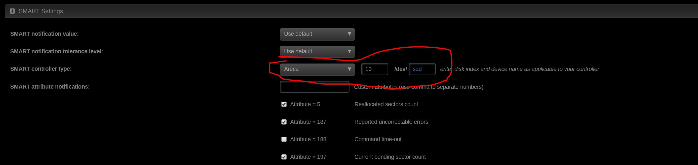

No however I played around in the UI and found some trigger points.
@limetech .. It will trigger on ANY disk spinup or spindown. I will trigger anytime in the UI to go into drive details
Within drive details it doesn't detect the details. Screenshot attached.
I tried changing 'Smart Controller Type' from Auto to Areca, but that'd didn't seem to help. The field wants me to enter a disk number, but in this case the drive is actually the parity so no valid disk number to use.

I also tried unchecking the 'attribute'  notifications, but it doesn't apply, the box will just stayed checked. Any more tests you'd like me to perform?

Your Areca controller configuration is incorrect. This is from the smartctl man page:
areca,N - [FreeBSD, Linux, Windows and Cygwin only] the device consists of one or more SATA disks connected to an Areca SATA RAID controller. The positive integer N (in the range from 1 to 24 inclusive) denotes which disk on the controller is monitored.
On Linux use syntax such as:
smartctl -a -d areca,2 /dev/sg2
smartctl -a -d areca,3 /dev/sg3
On FreeBSD use syntax such as:
smartctl -a -d areca,2 /dev/arcmsr1
smartctl -a -d areca,3 /dev/arcmsr2
On Windows and Cygwin use syntax such as:
smartctl -a -d areca,2 /dev/arcmsr0
smartctl -a -d areca,3 /dev/arcmsr1
The first line above addresses the second disk on the first Areca RAID controller. The second line addresses the third disk on the second Areca RAID controller. To help identify the correct device on Linux, use the command:
cat /proc/scsi/sg/device_hdr /proc/scsi/sg/devices
to show the SCSI generic devices (one per line, starting with /dev/sg0). The correct SCSI generic devices to address for smartmontools are the ones with the type field equal to 3. If the incorrect device is addressed, please read the warning/error messages carefully. They should provide hints about what devices to use.
Important: the Areca controller must have firmware version 1.46 or later. Lower-numbered firmware versions will give (harmless) SCSI error messages and no SMART information.
Also install the Dynamix SCSI devices plugin for a proper update of the udev storage rules needed for SCSI controllers, such as Areca.
This topic is a bit outdated, but may help (skip steps 1-3)

I'm on to something here. By finding that, I have now set the Partity disk Smart controller to 'Areca' 1 /dev/sdd
This has resolved one drive, sdd, from now having the 'sense' messages in the log. The other still logging the message are sdb and sdc.
  • sdb I can simply delete that volume, as it's not in use
  • sdc is in use via UnAssignedDevices. I don't see where in UD to configure the Smart Controller in the same way unRAID does. I'll look harder.
Interesting, definitely a step forward here in learning how to bring this towards a full resolution.
Share this post
Link to post
In the Areca manager I deleted logical volume 'Parity' which in unRAID was an unassigned disk 'sdb' the message is now gone.
The only remaining one is 'sdc' which is a UD managed drive. UD has no settings to configure Smart Controller Type.
Workaround... I'll move 'sdc' to be managed by unRAID as the Cache drive, where I can set the 'Smart Controller Type. Therefore all Areca managed drives will be managed by unRAID as an assigned disk. There will no longer be any Areca managed disks managed by UD or unassigned by unRAID.
:D RESOLVED:D
