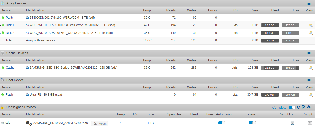

Silly question, I have the Samsung now as an unassigned device. Trying to figure out how to add it to the array.
Remotely, away at school. Something that is simple for them to do on their own.
Edited by Sabot
Here is a snapshot of the Main screen. On the unassigned drive, I moved the slider to the right for the Auto Mount and Share. Will it take time to have this drive mount to Disk 3 position or is there something else that I am missing?
Thank you so much for your assistance!!!!
Michael
Michael
Mounting the disk Unassigned will not add it to the array. You must stop the array and assign it to disk3. Then when you start the array unRAID will clear and format it.

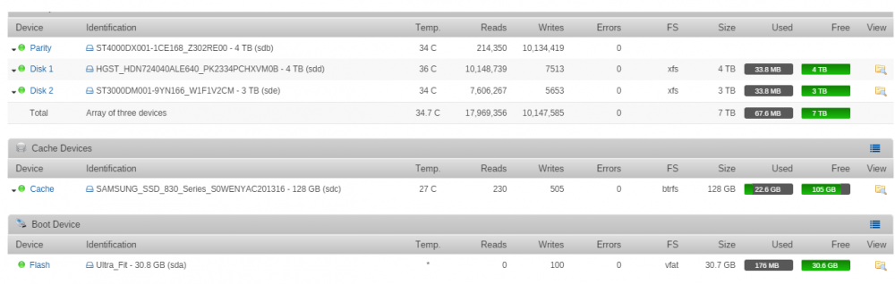

Here is my final setup.
