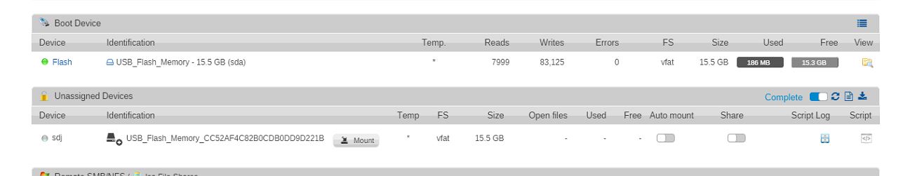

Well this is a strange one.  I start my Unraid and everything looks great, working the way it is supposed too.  I changed the background to black and it's great.  after a while, (not sure how long) but I will logon to the website using the name of the Unraid and it will not logon. I have to use the IP address. I then notice that my background is white again, can't access the dashboard and nothing is running. I can see the Main page and I notice that my Boot Device is under the Boot Device and Unassigned Devices at the same time.  If I do a reboot from the bottom link, it restarts and all if fine again.  well until it does it again. it could work fine for hours or just minutes. not sure what is causing the issue.  Screen shot of Boot and Unassigned Devices
Use a different USB port, USB2 is usually more reliable than USB3, failing that get a new flash drive.
I do have it in a UBS 3 so I will try that and report my outcome.  thank you for the quick reply, that means a great deal.
