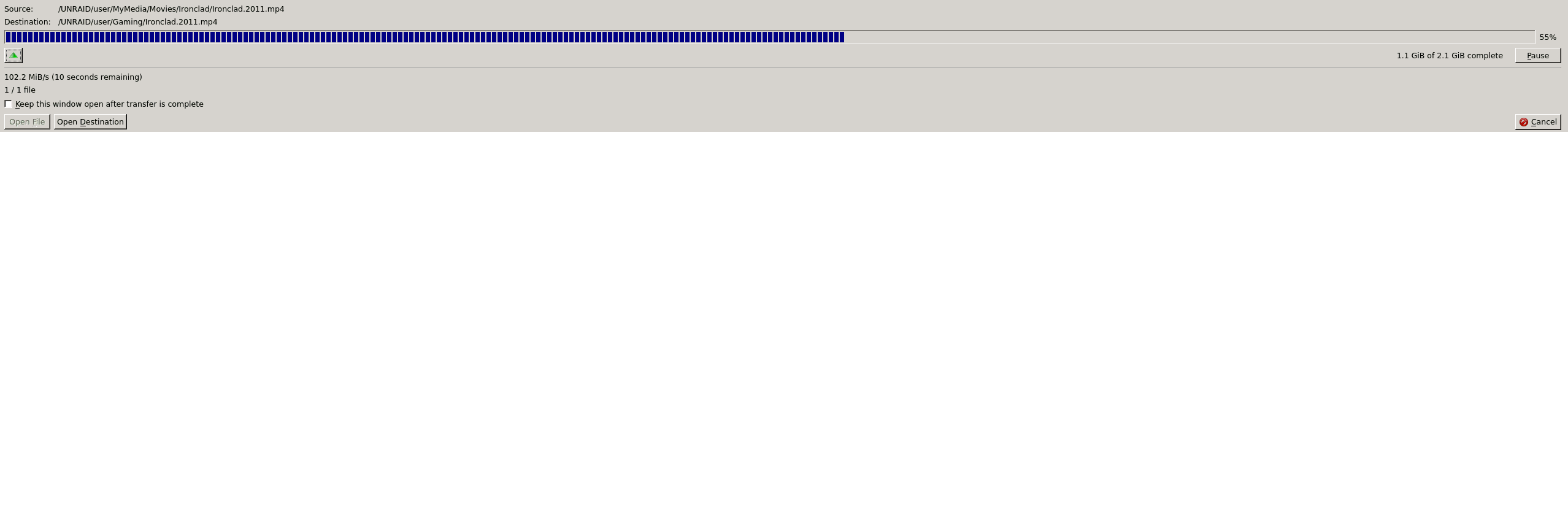

Not sorry for digging up this old thread, but I have the exact same issue but on SATA 3 controllers, BUT it is also happening to USB3 hdds too, any brand.  I had a few drives in Marvell controllers and I thought they were the problem, as there's posts all over these forums saying don't use them.  I had upgraded to the 2017 version firmware of the problem controllers and all my previous issues went away and they had worked perfectly since (4 of my onboard sata ports are marvell, and the 2 ports on a PCI-E card are also marvell).
All that said, the only way it can explain my issues with the USB3 transfer speeds would be if both of those external drives also had marvell controllers.  How can I check this?  Or since it's been almost 2 years since the last post, maybe there's a fix for this issue now?
