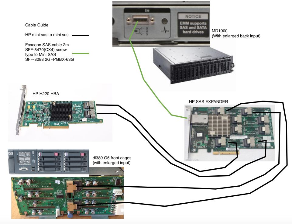

Mine is pretty straightforward, and thanks to 3rd grade art class, I can show you! (I can't show you an actual picture because the server is rebuilding a disk at the moment, and quite frankly it's harder to see with the cabling as it is in the machine anyways.)

Yup that works for me. So just to reiterate, your system reports an 8x connection through the HBA and you are running 8 disks off of 1 4x port in the rear and 2 disks in the front cage which should have a full connection each (No multiplexing)?
So I am seeing that you are running through a second, integrated expander in the MD1000. Does that sound correct?
So you have dual link between the HBA and the HP expander, so the 8 is correctly reported, you then have a single link between the HP expander and the M1000 (which is also an expander), naturally the HBA can only talk with the M1000 trough that single link, I don't know if fact that they  are cascaded introduces any other limits but don't think so.
Don't know if the front cages have another expander builtin ( it has if a single link can access all disks).

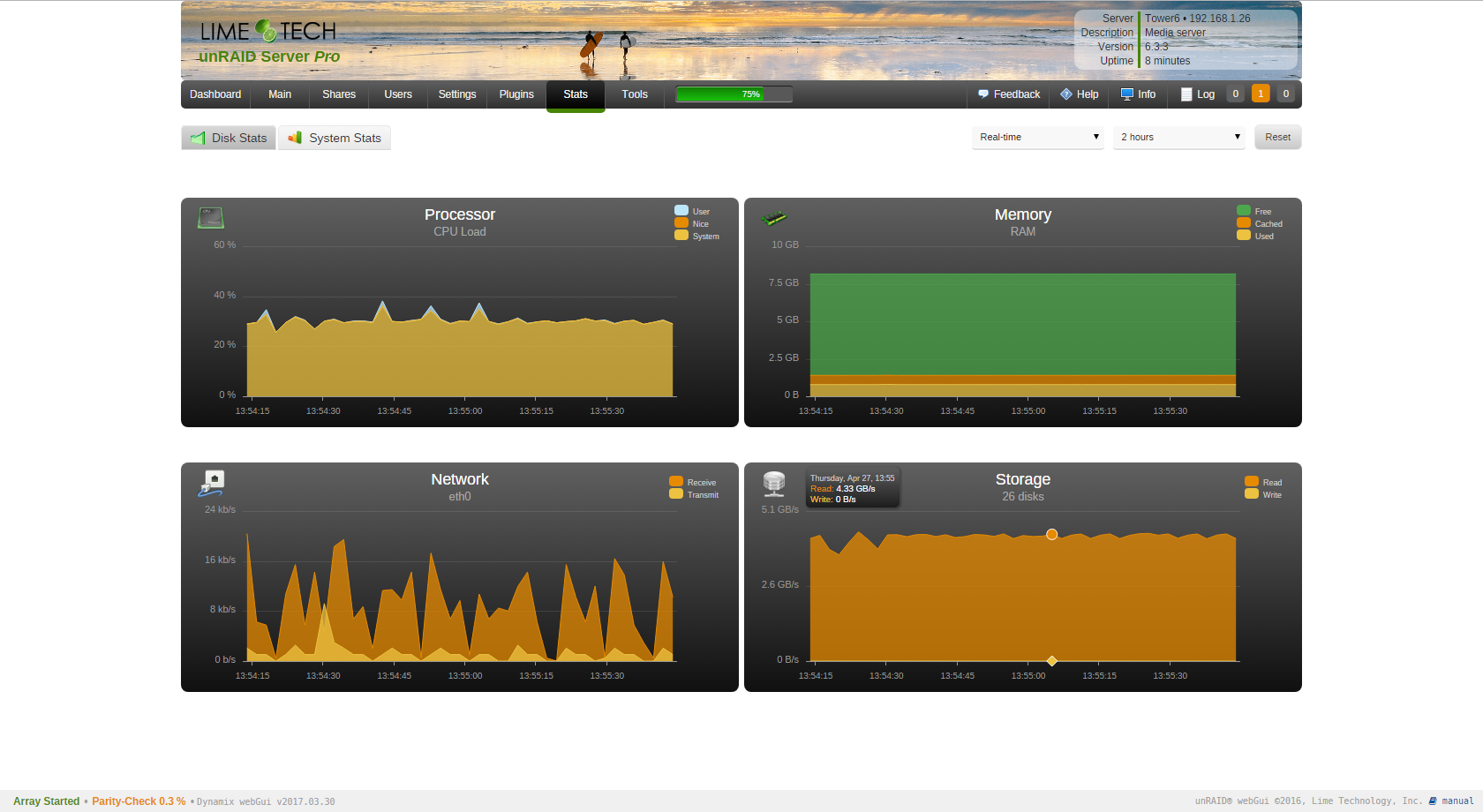

Don't think you can see anything about link speed in the diags, but I attached them below.
So, besides the 8 result I get I can be sure my expander is using dual link because it's the only way it could handle the 12 disks there connected without any limits, pic shows the start of a parity check, 4.33GB/s for 30 disks it's about 145MB/s per disk (and the maximum speed of the slowest disks in the server), so the 12 disks on the expander are using ~1750MB/s, well above the single link total bandwidth.

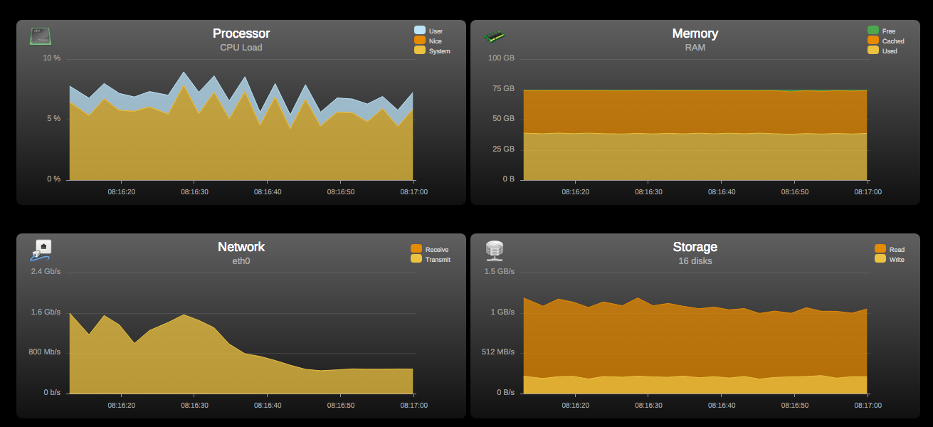

To help rule things out like HBA issues, I wanted to see how much data I could push through just the front cage, which as shown above is connected via the expander. This was done by running a read test on one one crappy ssd, a file transfer between 2 samsung ssd's using krusader, and a file transfer from another crappy SSD to another ssd on a server over the network.
5909caed7b884_ScreenShot2017-05-03at8_09_39AM.thumb.png.f497e87cd7e513c0dd89d3009361c4f3.png
So front cages can move more data, but, they are also connected via 2 ports on the expander.... so I'm not sure that rules any port limitation, but shows that the card can move more than the 500MB/s previously shown.

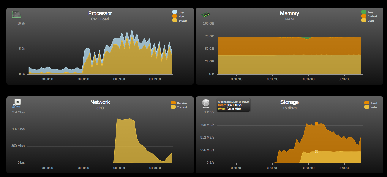

I then repeated the test (slightly modified using larger files for transfers between ssd's) and added in a parity check with the array:
5909cb545edb3_ScreenShot2017-05-03at8_17_01AM.thumb.png.9499796536f3e177951033774293e459.png

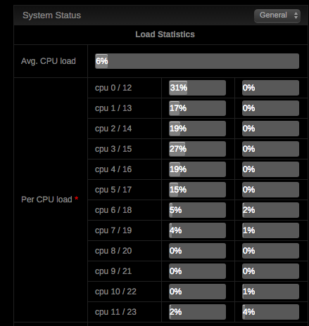

So, the HBA can move at least that much data through it. I do have my first 6 threads isolated only for unRaid on the main server, but cpu usage during the bigger test showed no bottleneck there
