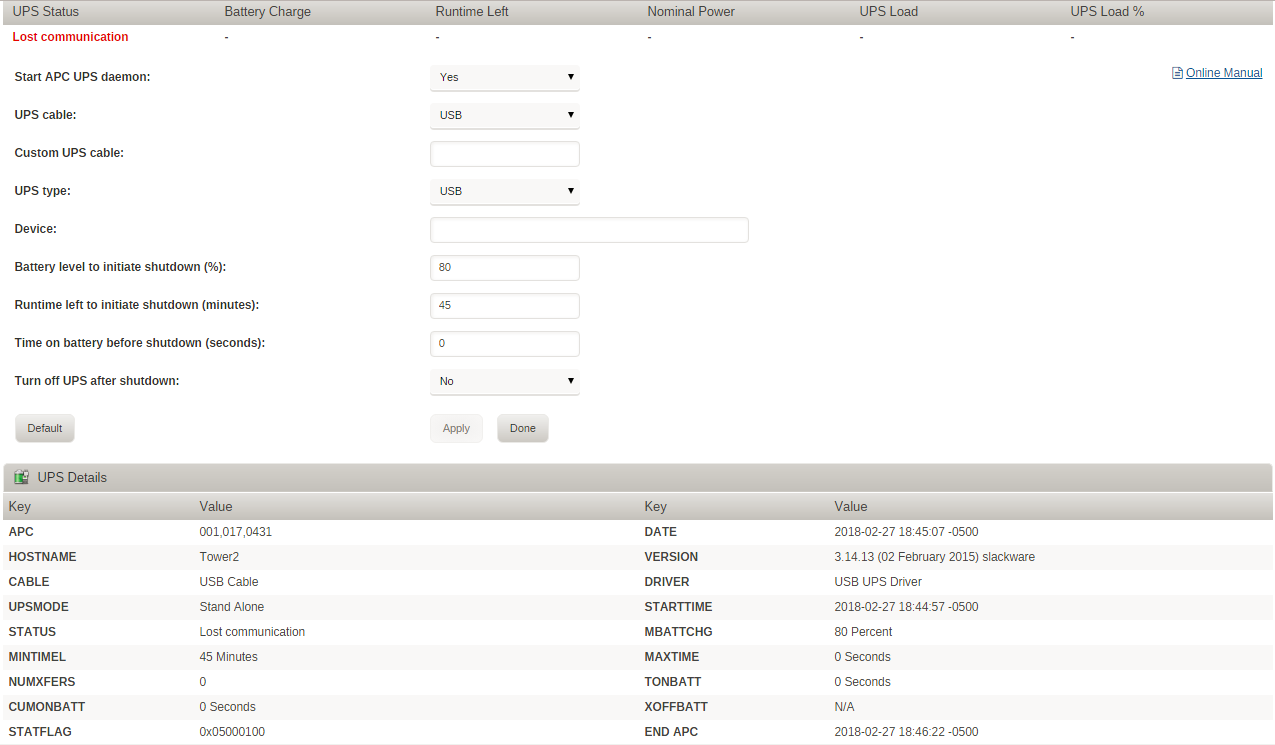

Setup a new server (second server) running 6.2.4 and unable to get the UPS set up correctly.
Have read the posts above and a few others. Not able to resolve.
Initially sees the APC UPS and then "lost communication."
I had the NUT plugin (deprecated and current) installed for a brief time but wanted to stick with the APCUPSD instead.
Attached is a screen shot of the details and the log.
Any help solving would be appreciated....

Here is the log....

SOLVED.....
Pulled the USB again but this time used an adjacent USB connection.
Communication restored.
Strange, but solved the issue.
