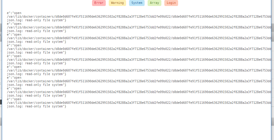

So today morning when i woke up i realized that plex wasn't working properly so restated the plex docker but  after that it is showing this read only file system error.Capture5.PNG.64af83aa79b68f4a07fa350ae0f28e4c.PNG

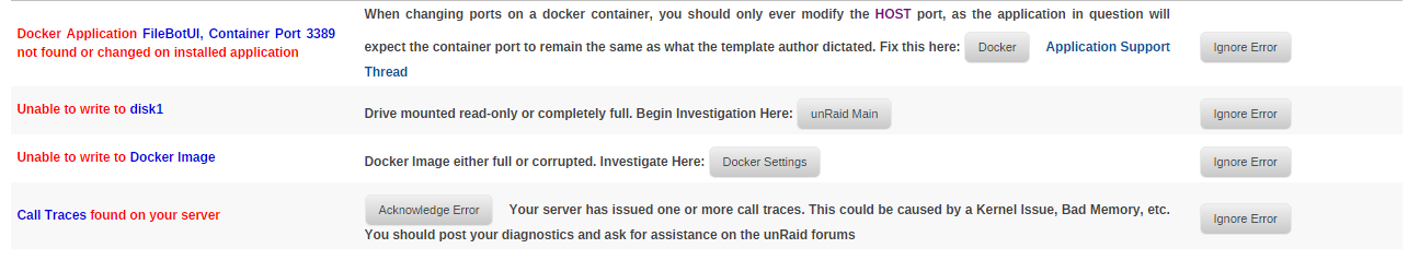

so i restarted my unraid array and now fix common problem plugin in showing these errors.Capture6.thumb.PNG.9b3deec75e2f7251a5f3610b042a1aae.PNG
Just forget about the filebotui error part, cause i did it on my own and it was working fine.
