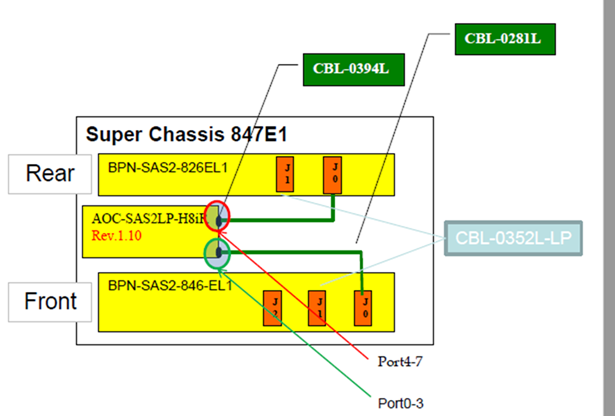

I get 4 which means single link. I am running a single dell H310 on my 36 bay supermicro server. I have connected the cables from my HBA the way they have recommended. I emailed them and asked about adding a second HBA to increase performance, this is their reply:
This is the model of my chassis:  6047R-E1R36N attached is a diagram of the backplane in my server.
Backplane support 2 cables connection from HBA or raid controller to backplane which would help to increase data transfer bandwidth. However, it will depend on raid controller able to support it.
Front backplane, BPN-SAS2-846EL1 contain total of 3 miniSAS (SFF8087) ports. Rear backplane, BPN-SAS2-826EL1 contain total of 2 miniSAS (SFF8087) ports.
You could make the connect from HBA to backplanes in two ways.
The way you have done is one way. One port on HBA card connect to front backplane, PRI_I0 (orPRI_J1/PRI_J2) port. Another port on HBA card connect to rear backplane, PRI_I0 (orPRI_J1/PRI_J2) port.
The other way is, using two cables connecting 2 ports on HBA card to front backplane PRI_J1 and PRI_J2. Use single cable connecting front backplane, Pri_J0 port to rear backplane, PRI_J0 port.
Prefer the way you have done the cable connection to backplane.

I have no experience with those backplanes but from the support response looks like at least the front backplane supports dual link, you could try option2 from response or get another HBA so you could use one dual linked to front backplane and the other single linked to rear backplane (single link is enough for 6 disks).
But IIRC your parity check speed was CPU limited so you may not see any improvements.
The second response intrigued me because they say using just one HBA, connect both connectors on the HBA using two cables to two of the three connectors for the front backplane, then using a third cable connect it to the remaining third plug on the front backplane to the rear backplane. Is this what you recommend?
I recently upgraded my CPU's to hex core models, so I have more horsepower :-)
Expanders can be cascaded, obviously there will have less bandwidth than if using 2 HBAs, but it's worth to try and see if there's a performance improvement, if there isn't you could be CPU limited and no point in investing on a 2nd HBA.
So I got my cable today and configured it the second way tech support suggested plugging the two cables from the HBA into the front backplane and then cascading the front to the back with a third cable. When I run:
cat /sys/class/sas_host/host1/device/port-1\:0/sas_port/port-1\:0/num_phys
I now get an 8 meaning I am running in dual link mode.
