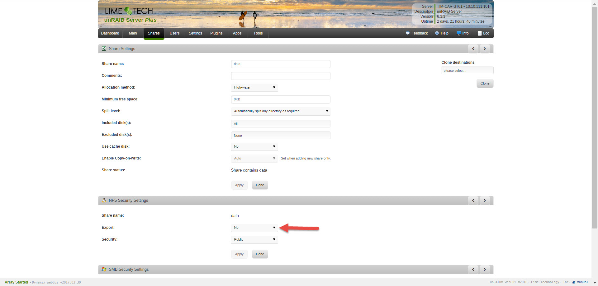

The symptoms are:
1. Dashboard tab is completely empty
2. My banner background is wrong (its set to the default picture but I had set a custom one)
3. The NFS share is no longer exported (I try to change it to "Yes" but always goes back to "No")
Please see screenshots. I also attached the errors and warnings from the past few days and the diagnostic file.

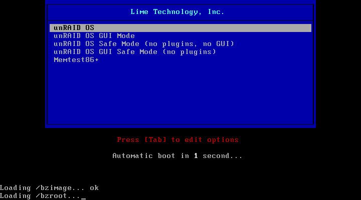

Just curios, the boot process hangs for a few minutes or so, could that hint to anything? It was usually faster then this before. Please see attached screenshot.
Perhaps I need to migrate to a new USB drive?
Same thing happened again. I'm trying on a new USB now.
After installing the new USB, it still takes a few minutes to load the bzroot image on boot up.
