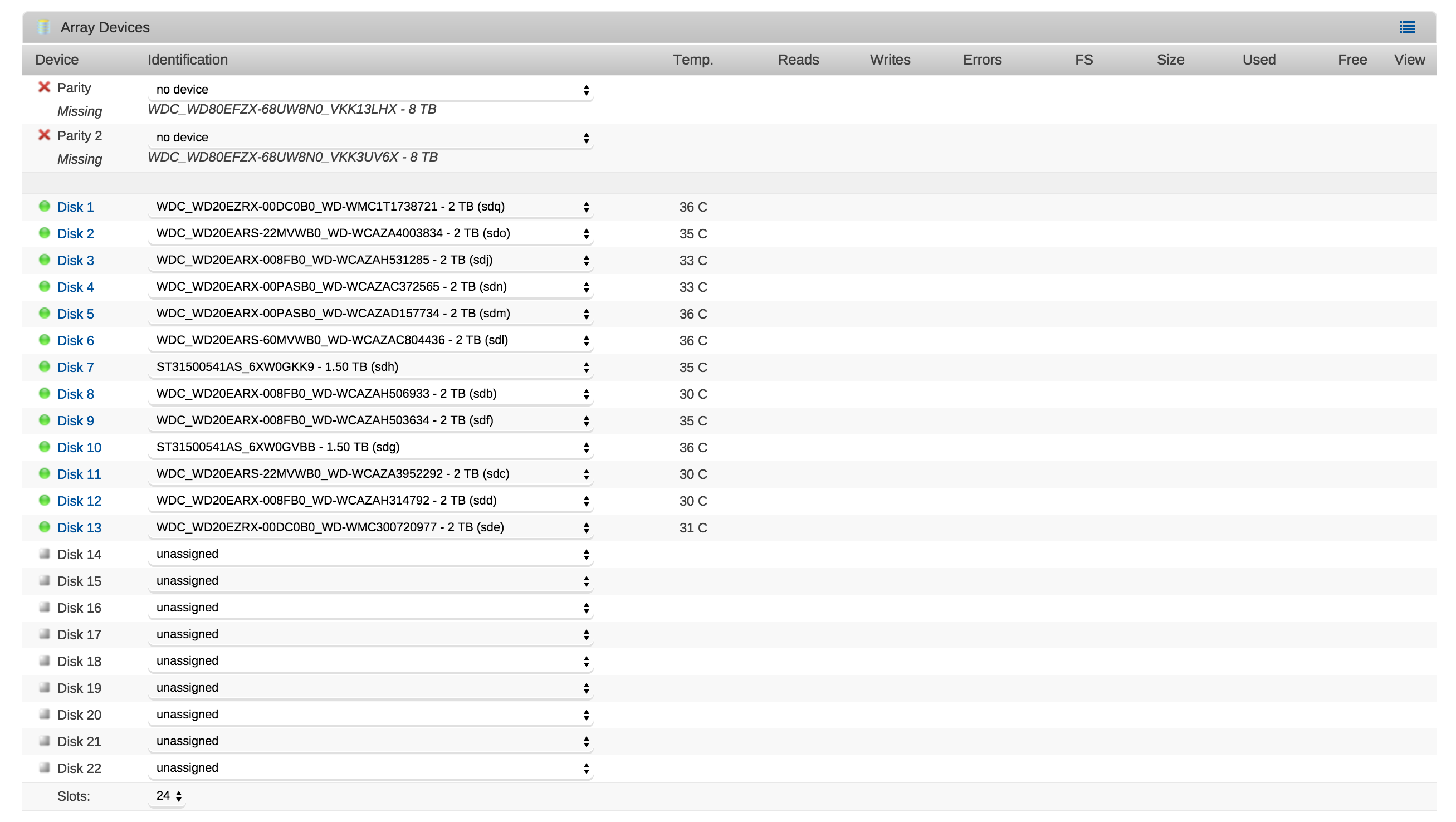

Hello - after many years of happy, broadly uninterrupted usage of my Unraid box, I rebooted tonight after finding the server had crashed.  When it came back online, I found both of my dual parity drives are "missing" in the drive list.

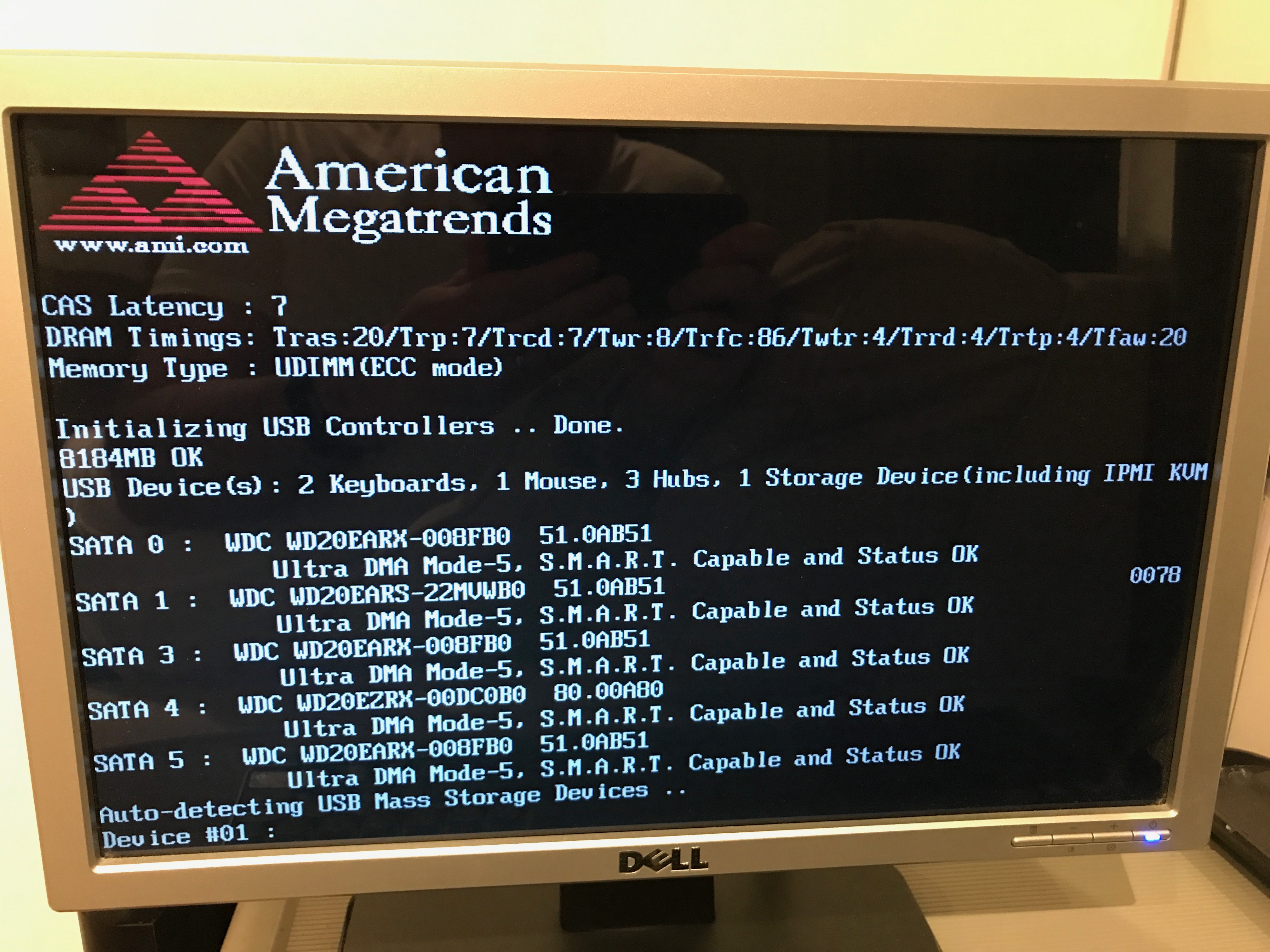

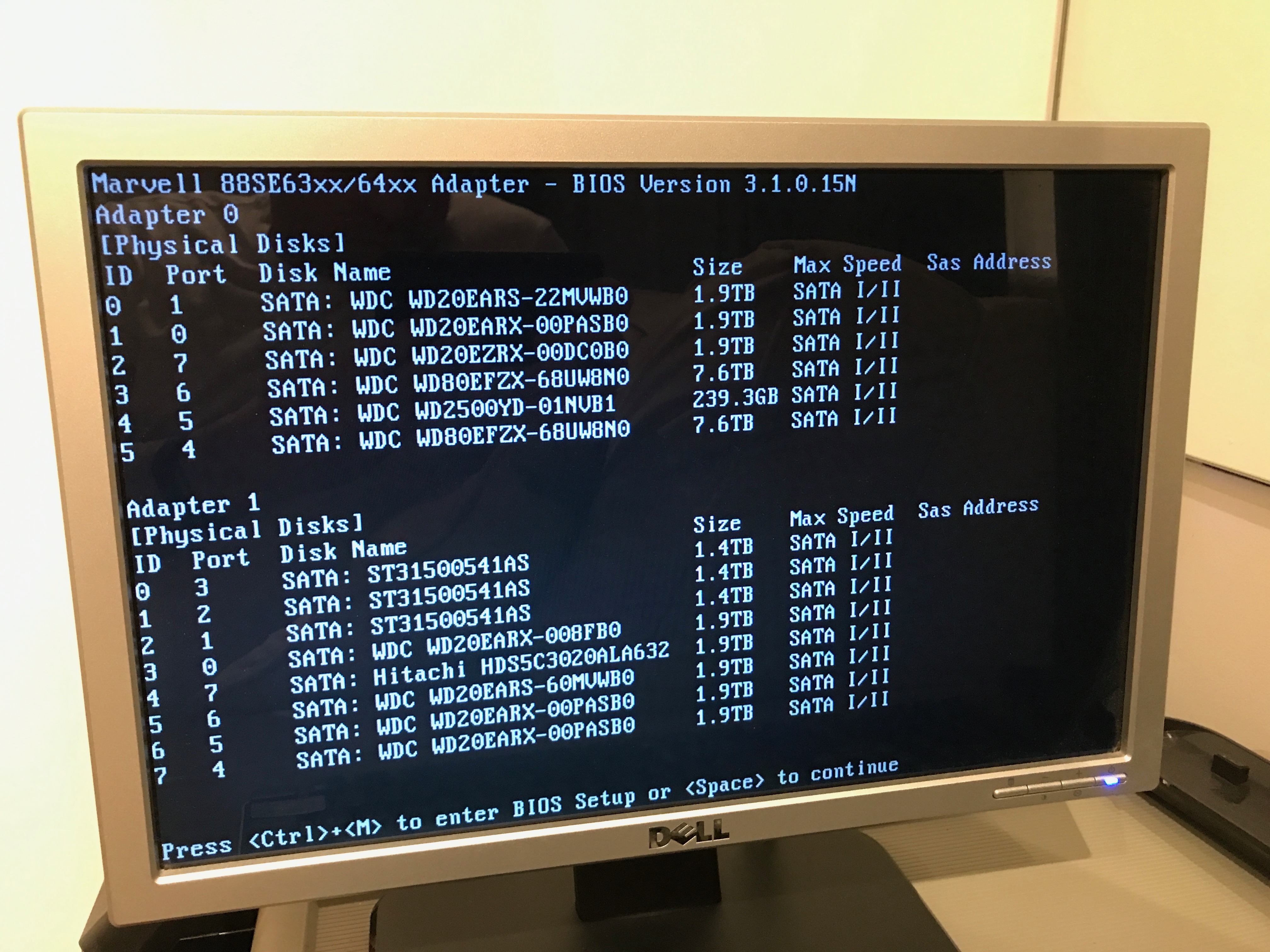

Hmmmm... seems unlikely they would have both failed at exactly the same time, so restarted again, and took photos of the boot screen, and as expected, they are showing up as connected drives to the BIOS.  But low and behold, still not showing up in the GUI.
Attached are screenshots of the GUI, the BIOS output, and log.  I was going to try to run SMART test, but don't have a [sdx] designation I can see to run it against.
Thinking that perhaps it's a bad backplane?  Just seems strange it's showing up ok on the BIOS screen if that's the case.

The syslog shows that Linux tried to get the 8TB drives to respond but they did not and were thus disabled.     Quite why I am not sure.   I would carefully check all the cabling and make sure the controller is properly seated into the motherboard.
It is possible that whatever caused the original crash HAS affected both drives.   Do you have another PC you could plug the drives into to run the manufacturer's test tools against them to confirm the drives are Ok?
Try connecting both parity disks on the onboard controller.
I had the same problem Months ago - BIOS showed the drive but unraid kicked it - Reason: A bad SATA-Cable.
I changed the cable and all was fine.
I never had problems with unraid (or SATA-Cabeling) since 7 years, but since v6.2.x it seems, unraid is a little bit bitchy xD
What i do now when changing a Disk, i also change the SATA-Cable too to prevent this "kickoffs".

Thank you all.  After posting this, I moved the drives to different slots, and rebooted.  When the Unraid management page came up, everything was normal.
