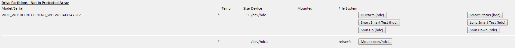

I'm trying to set up SNAP for an internal hard drive. I want it to have 3 partitions, so I formatted and partioned it on my Windows PC (2 partitions are 250gb each and 1 partition is 500gb). At first I tried to not format them to any type so I could create a reiserfs filesystem on it. That didnt work, so I deleted all the partitions and created 3 new partitions, this time formatted with NTFS. This sadly doesnt work either.
In unMENU the partitions are showing up as you can see in the image:
I do not know why it says there are 4 partitions, but I think its some sort of metadata of the disk (referring to hdc1) (if there could be some sort of metadata). Pressing "Create resierfs on /dev/hdc1" gives me the following message:

I think you will find that partition 1 is an 'extended' primary partition that contains the other partitions.    The rational for this is that the DOS partitioning scheme only allows for 4 primary partitions, so partitions inside an extended partition start at 5 and go upwards.

Okay, I think I got it fixed.
The problem was in the used SATA cable. I found out this was the problem because my harddisk had "hdX". It should have been "sdX".
