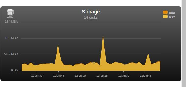

So, in further troubleshooting, I set all of my containers to not auto-start and then rebooted my server again.  Once back up, I kicked off another parity check and I was getting the expected speeds (80mb/sec - 140mb/sec). It ran like this for about 30mins and then dropped back down to 56kb/sec.  This is with literally nothing running but UnRaid.  Not sure what is causing the disk usage. Attached is a picture of the current disk usage with nothing running.  Anyway to figure out what's eating it?

After rebuilding just about everything today, I was finally able to figure out what was causing my slowdowns.  Putting the answer here, so in case anyone else runs against the same problem.  After starting dockers one at a time and watching the disk throughput via a parity check, it was SickRage causing the issue.  Turns out I had a ton of crap in the post-processing folder and when it would go to post-process, it was extracting a ton of crap all at the same time and trying to move it to my specified folders.  Weird thing about SickRage, it was also extracting movies, decided it didn't know what it was, and then moved on.  I had a lot of movies in my post-process folder.  So, I moved everything out of that folder that had already been post-processed, started back up SickRage, and here we are almost 45mins later and no issues.  I had successfully run Deluge and Plex for most the day and had no issues.  But, as soon as SickRage hit the post-processing task, there would go my speeds again.  It must spawn off a bunch of child threads when post-processing, as killing the SickRage container wouldn't bring my speed back.  It would take almost 20-30mins for it to finish what it was doing (even though the container was stopped) before it would go back to normal.  Hence the hard time trying to pin out the root cause.  Anyway, I hope this helps someone else.
