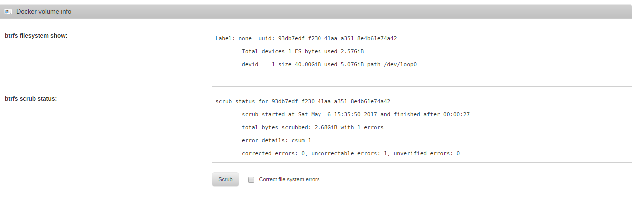

So guys i just ran scrub test and its showing one uncorrectable error.

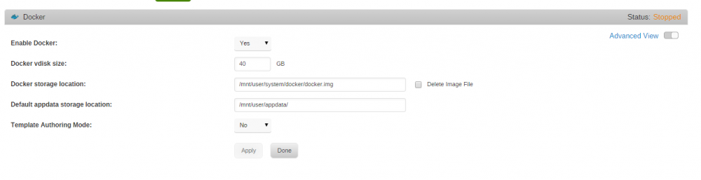

Just now i was trying to delete docker image so i order to delete docker image it tried to stop the unraid array but then it got stuck at unmounting disks so i had to hard reboot.
So now after deleting docker isn't loading properly.
Its like this.

Stopping the array isn't the correct procedure, and I doubt you could delete it with the array stopped anyway since all disks would be unmounted.
What you should do is go to Settings - Docker and stop docker then it will let you delete it and recreate it from that same page.
So how did you delete docker?
Your screenshot is unclear. Is that the Docker page or the Settings page?

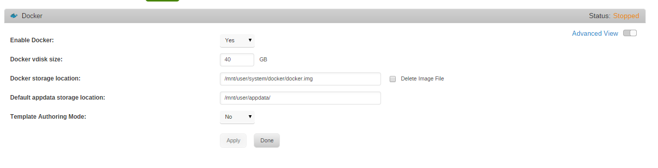

that's the docker page.
Actually earlier in docker settings page delete option was not appearing, so thought maybe they appear after stopping the array.
i dont know why the status says its stopped.
Change Enable Docker to No
Why do you have it set so large? You must be doing something wrong if you are filling up 40GB. I've never heard of anyone needing more than 20 unless they were doing something wrong.
Have you read the Docker FAQ?
okay set it to "no" now, what's next how am i going to use dockers after disabling it.
As for docker image being so large, Actually earlier when my docker image got corrupted fix common problem plugin reported that it could be docker image is full, so at that time when i created a new image i also increased the size of it for just in case.
But after that i kept an eye on it so now i know i never used more than 5.5 gigabyte, so yeah im not doing something crazy.

I just ran scrub test on disk and now its showing this error.
Edited by Max
I assume that is disk1, btrfs is not very tolerant of hardware issues like those frequent ATA errors, you'll need to get to the root cause of that and reformat disk1.

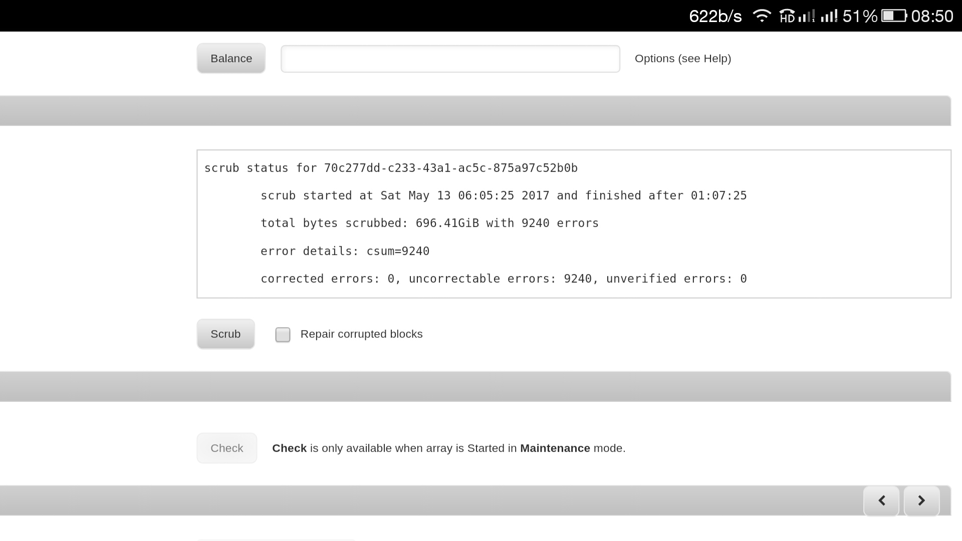

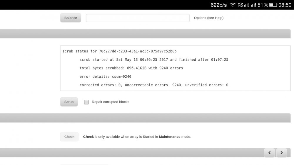

@trurl @johnnie.black so guys it turned out to be a psu related issue, so just yesterday i bought a new one and ran smart extended test and it ran find but after that i also ran that scrub test but it's giving me this error on disk.
So what should i do now?
