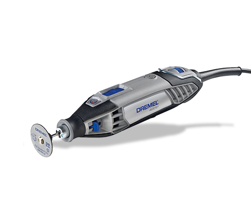

I don't think it will physically fit the slot.  It's a 1x only slot.
But then you're running a card on a single PCI-e lane, which affects speed.
Which is still faster than sitting in the box!
