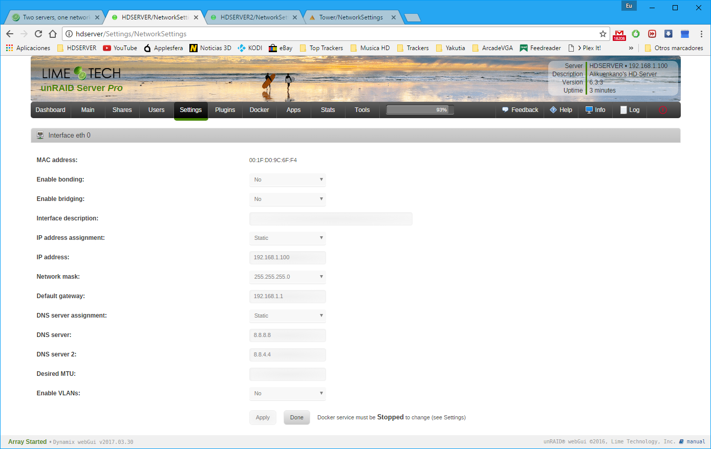

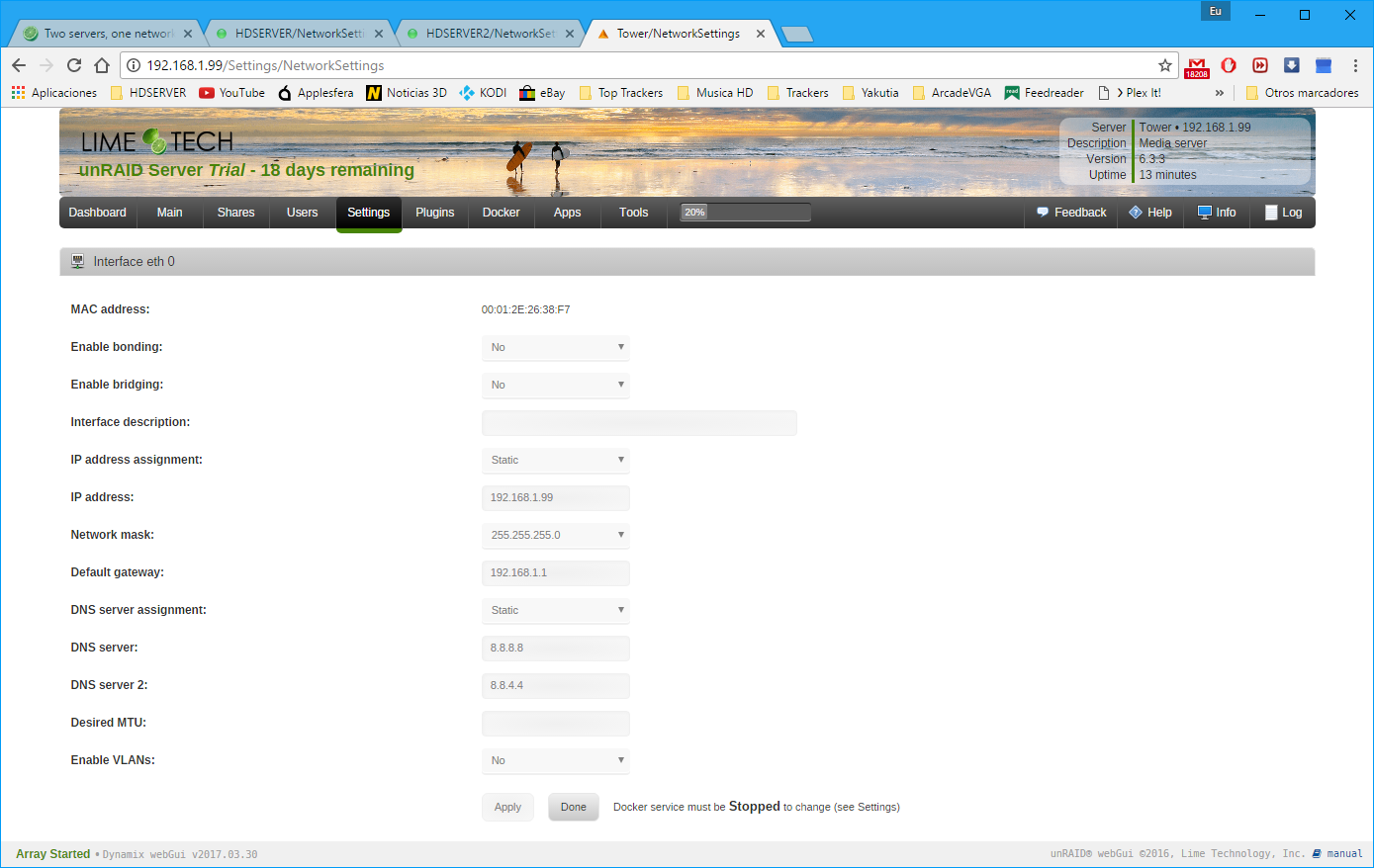

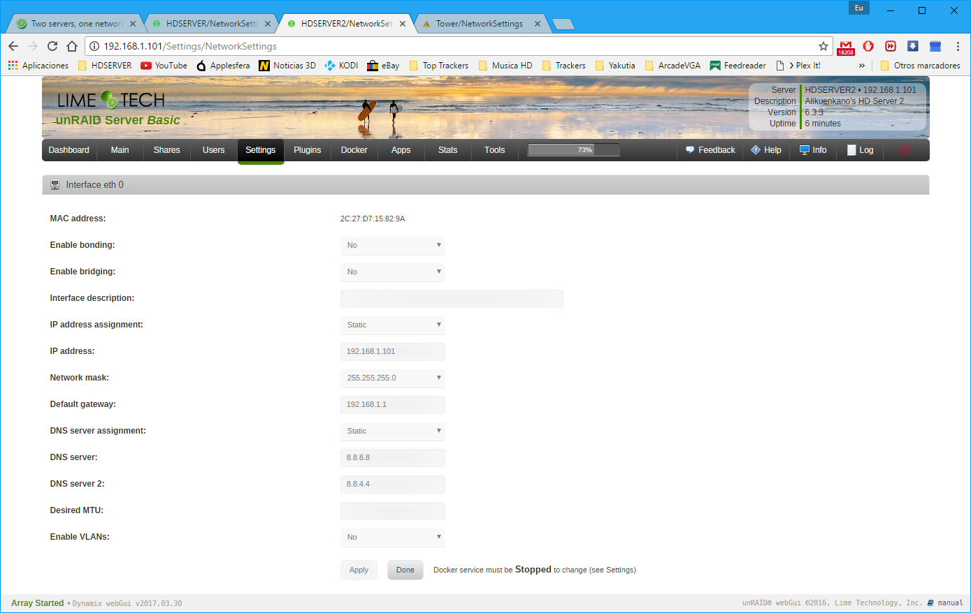

I attach network settings of the two servers and the test server.
At home I have a wimax internet connection, with a Ubiquiti LiteBeam M5, that is connected to an TPLINK 8 port gigabit switch, for some equipment I have in my home cinema room. From this switch, goes one network cable that goes to a DLINK 8 port gigabit switch that connects to my pcs and my servers.
Everything has always worked well, until one month and a half ago, approx. I have not changed nothing in the servers nor in the network installation. It's very strange for me. I can not find a logical explanation.
Thanks for your help.
