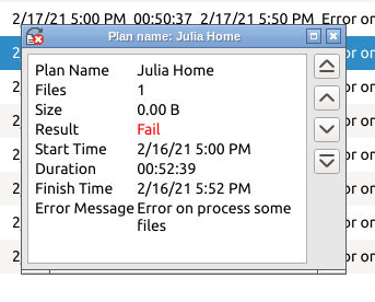

Hello everyone,
I bought cloudberry recently and a view days ago the backup is starting to fail.
I did not change anything with the docker or on the remote site. I am backup up to an old Synology NAS at my mom's house through sftp.
Is there anything I can try to solve the problem?
Thanks a lot
7 hours ago, Bob@unraid said:
Hello everyone,
Thanks a lot
Do you have more details about the failure if you go under History->By Files ?
If not, you could have a look at the following log files: /mnt/users/appdata/CloudBerryBackup/logs/log_worker_*
Finally, is the failure occur every time the backup runs ?

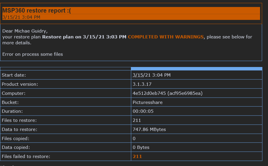

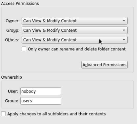

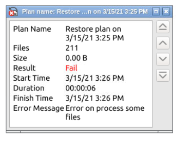

I can't get a restore to work either.
Originally created a big container using encryption and backed up a lot to it. Using the "browse fiies" option on the Backblaze site shows what looks iike the correct files, tho couldn't download them because of encryption.
To eliminate encryption as a variable, I created another container for pictures with no encryption. Backup completed and I could browse the files on the Backblaze site and download and view individual pictures in my browser.
Below are permissions.
But still can't get a restore to work. Created  a new folder to restore to. image.png.916a3a14a50e5d01df17ff95aaa921b7.png
As per a previous post, checked the time and it was correct.
Each time I try to restore a picture folder, it fails with the following error
I asked it for a detailed email report and it sends this which is not helpful
Help?
Help?
What is the location where you are restoring the files?

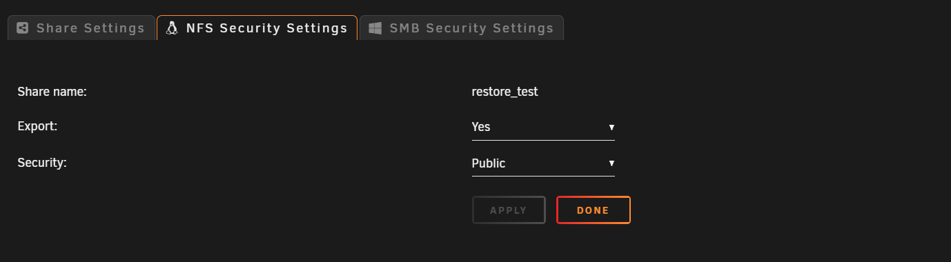

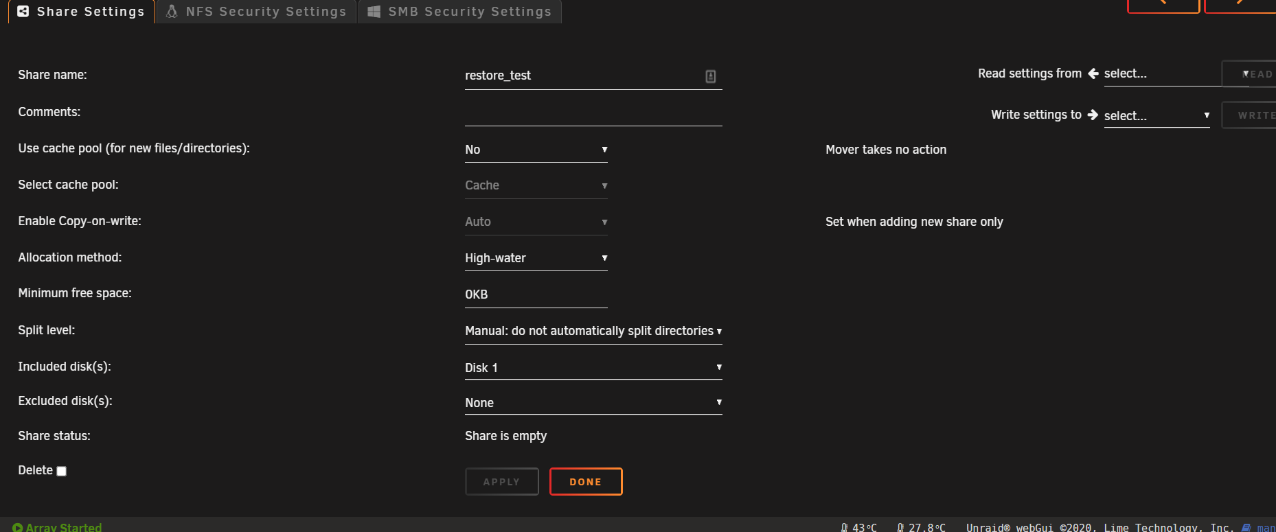

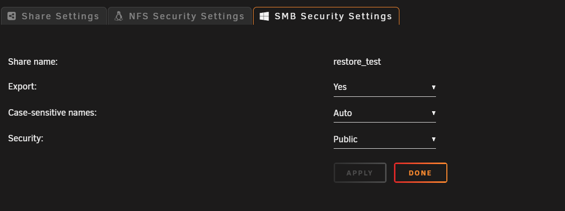

Sorry. Just found this. Created a separate share to eliminate variables. This is it, along with permissions. Not a linux wiz, so may be something simple.
Thanks.
Thanks.
And when you added this path to the container's setting, did you set it as read/write ?
