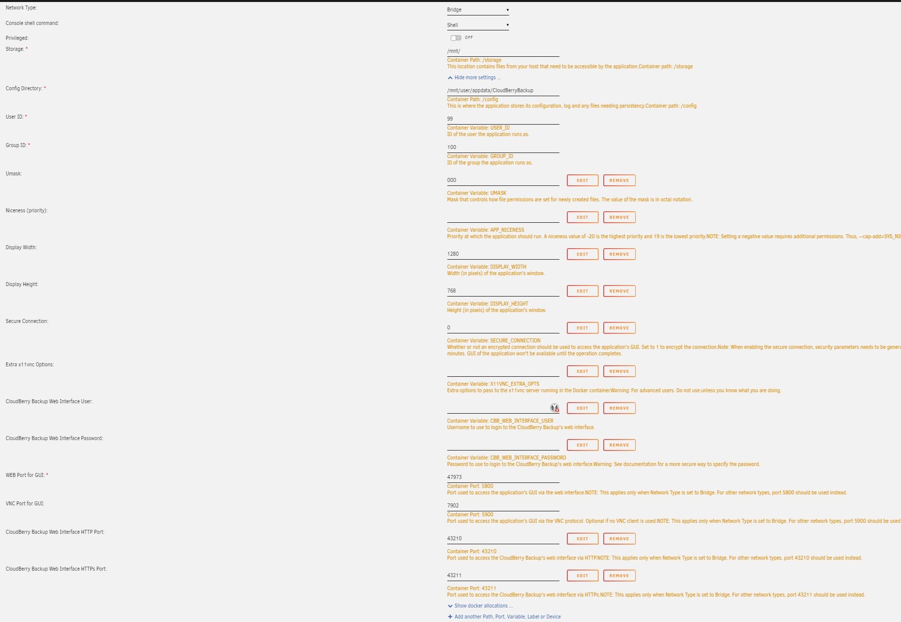

On 4/11/2022 at 5:38 PM, Bob@unraid said:
I recently tried CBB after some time to backup some files to a remote unraid server using a vpn and mount this server a remote share on mine.
I set a remote share as the backup storage in CBB using "file system" as storage using the /storage/remotes/REMOTESERVER/ path.
I tried some folders with some small files and after a while unraid noticed my that my docker file is growing to ~85% from like 75%.
Is CBB backup up the files to the docker file at first time or did I something set up the wrong way?
Thanks a lot!
This doesn't seem normal.  You might want to share you container config so we can better understand what's happening.
For sure. I attached the screenshot of the docker settings. Is there anything else I can / should post?
Thanks
Thanks
And how  it's setup inside CBB ?
Also, I guess you had to change /storage to be read/write ?  You are probably better to add a new "Path" that will be used as your backup destination in CBB.
