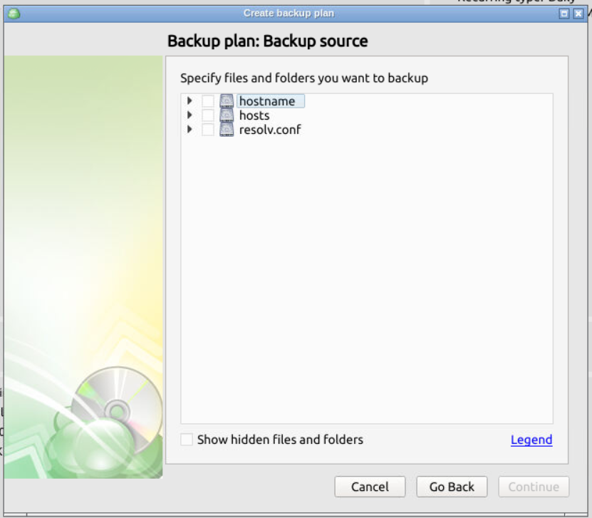

On 11/27/2022 at 1:27 PM, michaelben said:
I've got an issue configuring CloudBerry on Unraid. When I run CloudBerry, the "storage" folder - the main folder to backup is missing from the GUI.
One peculiarity is that I previously ran docker on BTRFS image (about a year ago), and CloudBerry was working fine. I switched to XFS because I was having some other issues with the image, and CloudBerry stopped working - that is, there is nothing to backup.
I tested today and temporarily switched to a new BTRFS docker image, and everything started showing up again! However, I am reluctant to switch to BTRFS permanently unless absolutely necessary to get Cloudberry to work.
Why would it work fine with btrfs but not with xfs image?? Is this permission related issue (I don't change any file permissions, just switch docker image over from my docker.img to docker-xfs.img... If so, how can I fix it?

2 hours ago, michaelben said:
I did that 6 months ago and didn't go anywhere... what about the fact that it works fine under BTRFS and not under XFS? Isn't that the underlying issue?
The mount type for "/" is different in both cases.  Since CloudBerry Backup seems to work by mount point, it is possible that it doesn't recognize it.
Under XFS, can you try to run "docker exec CloudBerryBackup mount" ?
How would CloudBerry support address this if they don't know I'm running in docker?
From the app's point of view, it's not really important if it is running in a container or not.  However, support might be quick to close your case by answering that running in a container is not officially supported.
/storage is definitely there when I'm in the container console, but not in the GUI. "mount" command doesn't change anything, it looks already mounted
/tmp # df -h
Filesystem                Size      Used Available Use% Mounted on
overlay                  50.0G     29.9G     20.0G  60% /
tmpfs                    64.0M         0     64.0M   0% /dev
tmpfs                    31.4G         0     31.4G   0% /sys/fs/cgroup
shm                      64.0M         0     64.0M   0% /dev/shm
shfs                     50.9T     38.2T     12.8T  75% /storage
shfs                    931.1G    350.2G    580.9G  38% /config
/dev/loop2               50.0G     29.9G     20.0G  60% /etc/resolv.conf
/dev/loop2               50.0G     29.9G     20.0G  60% /etc/hostname
/dev/loop2               50.0G     29.9G     20.0G  60% /etc/hosts
Yes sorry, I wanted to see the output of the command.
/ # mount
Edited by michaelben

6 hours ago, michaelben said:
/ # mount
Humm this command should output something...  Did you run "docker exec CloudBerryBackup mount" ?
Yep...
root@Unraid:/# docker exec CloudBerryBackup mount
root@Unraid:/#
root@Unraid:/#
