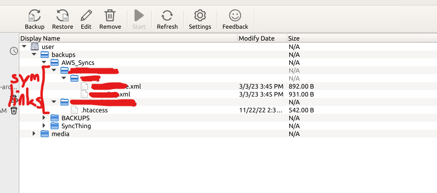

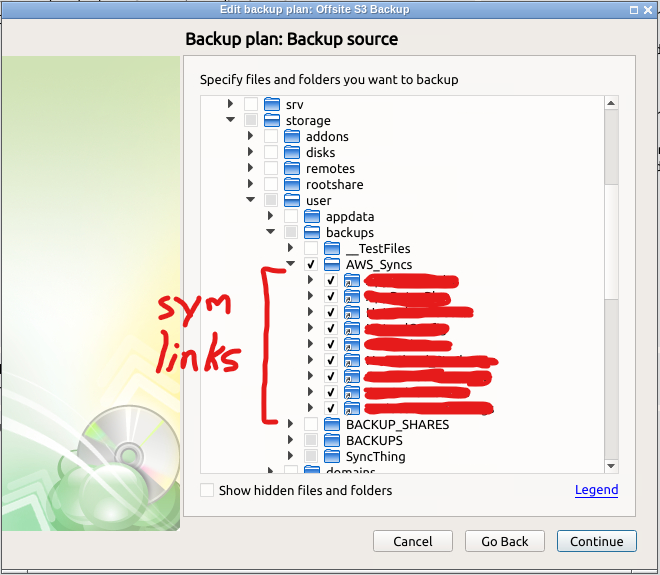

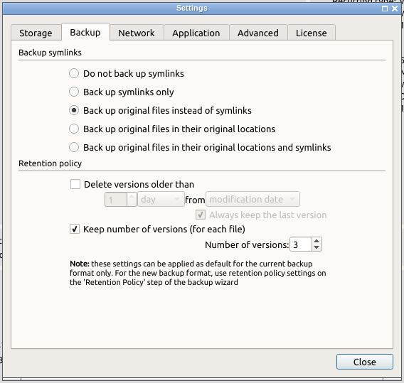

Hi guys, I reported the problems I'm having a few posts ago back in mid-February, but I'm still having issues.
I was encountering an error code 1500 reporting that my backups are over 5.5TB, even though they are not.
I seem to have noticed that its not backing up my symlinked directories though, even though Cloudberry claims it supports symlinks. I have a few symlinked directories that get updated regularly via a backup script, the script locally copies files from remote servers and updates the dir symlink to the backup of "latest".
In my server is a single directory called "AWS_Syncs" that I symlink other dirs under (No remote or inaccessible links) so that they can be updated and backed up transparently under a single dir.
I have docker mapped my host /mnt to containers /storage dir, is this correct?
Should I be mapping unraid host /mnt to container /mnt instead?
When I setup my backup, I can browse the symlinked dirs, and select anything I need, which for me is everything.
However, I think Cloudberry is having trouble at the time of backup because when looking at backups I cannot see anything being backed up from these dirs:
Is there a permissions issue, even though they seem to be accessible?
Maybe there is a set of permissions or access that Cloudberry is looking for?
I've played with the "Backup Symlinks" setting, and have not had any success yet.
Anyone have ideas?
Did you check if symlinks were broken inside the container ?
docker exec CloudBerryBackup ls -l /storage/user/backups/AWS_Syncs
If symlinks are using pointing to absolute paths, they could be broken inside the container.

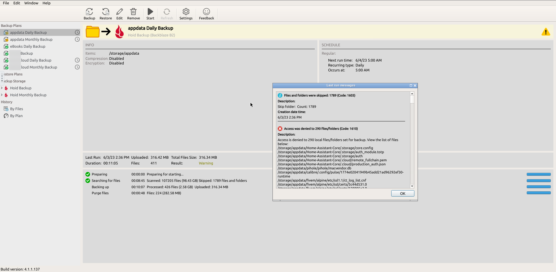

Hi, I am having trouble with backing up my appdata folder. My other back up routines work fine but anything within the appdata folder seems to either error and not work at all some days, or works with "warnings", and when it does this it is not purging any of the files and so I am ending up with hundreds of copies of them over time and have to manually delete them from cloud storage.
I believe it is probably something to do with permissions and cloudberry backup not having full access to some folders but I have no idea how to change its permissions to fix this error.
Cloudberry backup is already running in privileged mode. I have attached a screenshot of the latest error.
What are the ownership and permissions of theses files ?  If the related containers run under a different user as CloudBerry Backup, it is possible that it doesn't have access to the files.

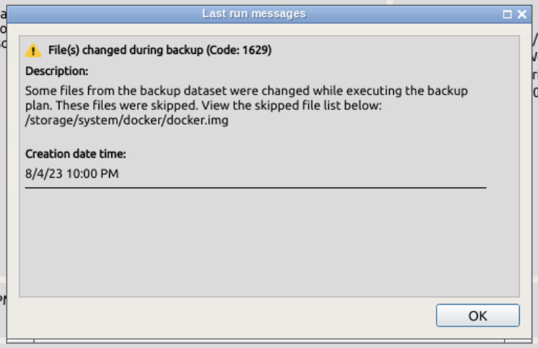

I've recently started experiencing the following error. Does anyone know if this is a Cloudberry or Unraid issue? I have done a bit of Googling but cannot seem to find a resolution for this.
