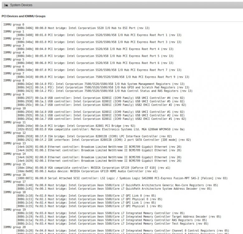

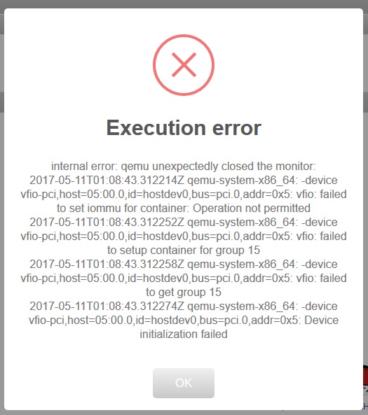

Perfect, thanks for the information.  I was able to snip out the back of one of my 8x slots (they are on a riser so and I don't really need them) to fit in a GT610 I had laying around.  The Server boots with it, so it must be under the 25W requirement and the card shows up in UnRaid System Devices, but when I try to set it as the Video and Audio cards I get an error starting the VM.  With the VM set up to use VNC it works fine.  Any thoughts?
Thanks,
DBS
Edited by dbs179
Added Images
Your IOMMU grouping is fine for the card with the video/audio components in their own group.
On Proliants and multiple other legitimate older servers, you need to modify your syslinux.cfg to allow "unsafe" interrupts (Main tab: click on flash, make changes, apply, reboot )
  append vfio_iommu_type1.allow_unsafe_interrupts=1 initrd=/bzroot
If this doesn't work, you can look in your system logs for a DMAR/RMRR issue with the GPU, or just post your diagnostics (Tools tab: diagnostics) and we'll take a look.
If this works, you may still encounter an issue with the GPU in windows giving an error (40 or 43 or similar, I don't remember.) But one thing at a time.
