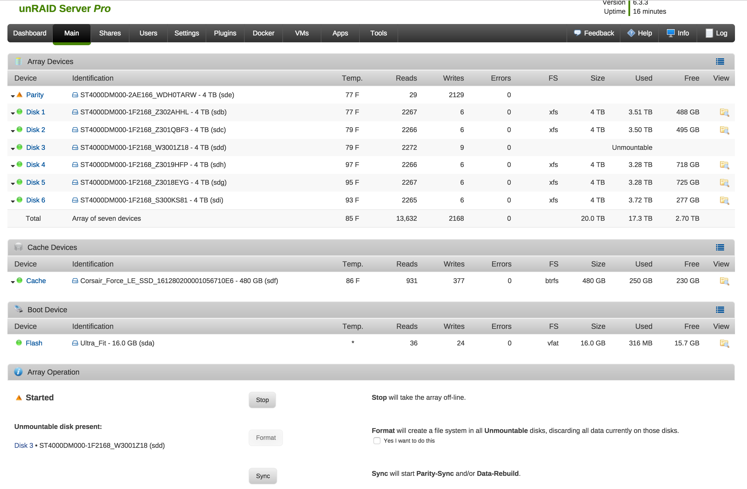

- parity drive had some i/o errors, thinking it was the cable, moved a few cables around and rebuilt with a new parity drive.  NO ISSUES.
- rebooted this morning, after a successful parity rebuilt and check; one of the data drive, drive #3 shows unmountable (XFS file system).
- CLI: "xfs_repair -v -L /dev/sdd" to see if that would resolve the issue. ended up with:
Phase 1 - find and verify superblock...
bad primary superblock - bad magic number !!!
attempting to find secondary superblock...
- this "......" goes one for 10+ mins with no avail.  I ended up powering down the server and replacing the hard data drive with the another drive.
- new drive shows up as needing formatting (not a surprise) but also as unmountable (surprise).
- i end up doing both... UGH.  should i have?  Now i'm afraid that i reformatted the drive to blank and rebuilt a party around blank.  I can't tell, because there's 6 more hours of rebuilt left... but the formatting is done.
- i guess the only saving grace i have right now is that i have the old data drive i pulled that has all my data (i care about saving the data); but is xfs unmountable.
folks----> where did i go wrong?  did i go wrong? and how do i get myself out of this very stressful situation?  Can i mount the old data drive external to the array and copy over the data to the formatted disk 3 or should i mount it via Mac OSX/Win10 and move from there?

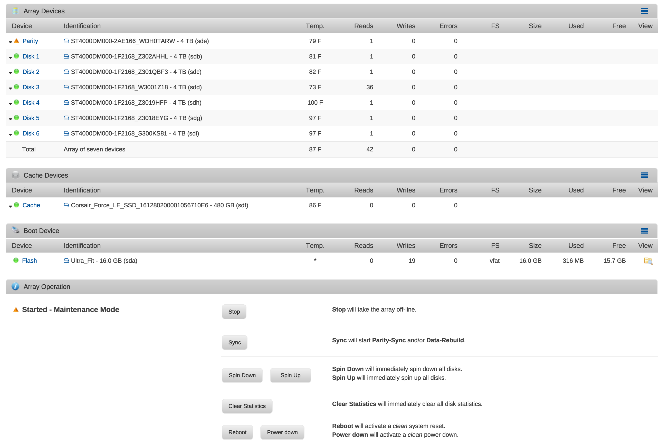

started the array in maintenance mode, no parity sync started, but all disks are green circles, party is a orange triangle.
no FS/size/used/free is read! (is this because it's maintenance mode?)
went to CLI and ran:
root@Tower:~# xfs_repair -v /dev/md3
        - block cache size set to 4575984 entries
Phase 2 - using internal log
        - zero log...
zero_log: head block 1169372 tail block 1169368
ERROR: The filesystem has valuable metadata changes in a log which needs to
be replayed.  Mount the filesystem to replay the log, and unmount it before
re-running xfs_repair.  If you are unable to mount the filesystem, then use
the -L option to destroy the log and attempt a repair.
Note that destroying the log may cause corruption -- please attempt a mount
of the filesystem before doing this.
... goes back to command prompt.
not sure what to do from here.
Edited by pkh106

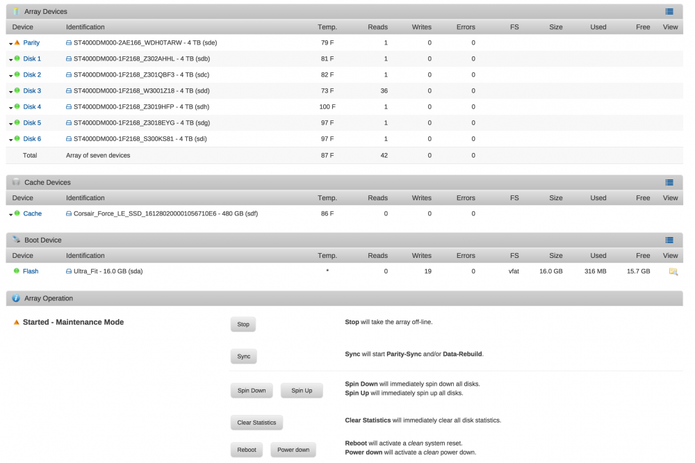

so... this appears to be where i was earlier, prior to swapping out the drive... except for the fact that my parity drive was a green ball vice orange triangle
Edited by pkh106
