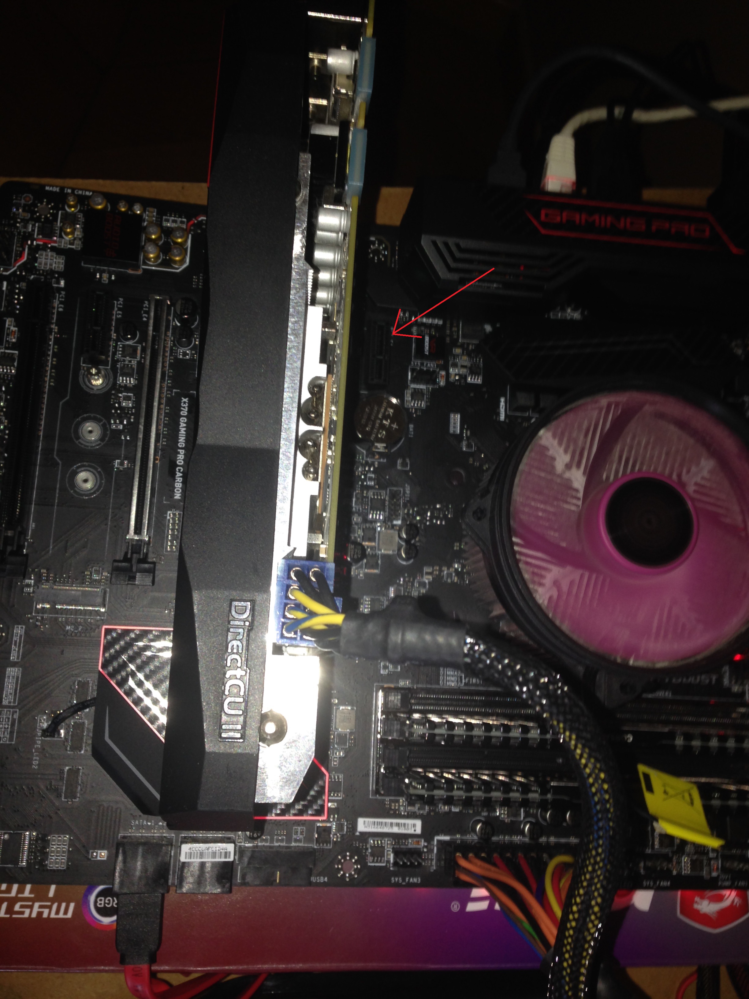

I was wondering if i could use the top PCIe 1x slot to boot on the unRAID console because i only have 3 PCIe 16x on my motherboard.
I included a pic of the PCIe 1x slot i would want unRAID to boot on.
