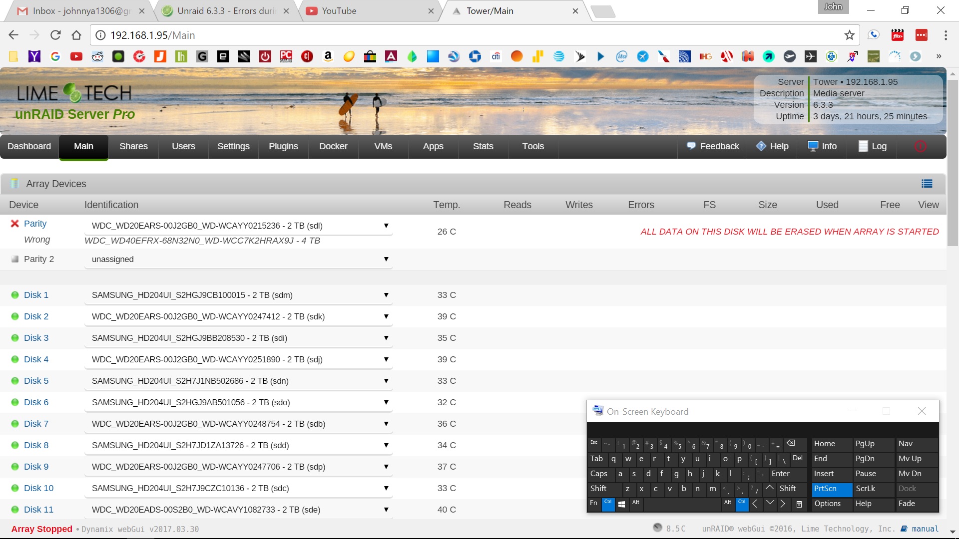

To do it you need to do a new config (select retain all disks) with the old parity and current disk13, check the box "parity is already valid" before starting the array, start array, stop array, power down, replace disk13, power back up, assign new disk, start array to begin rebuild.

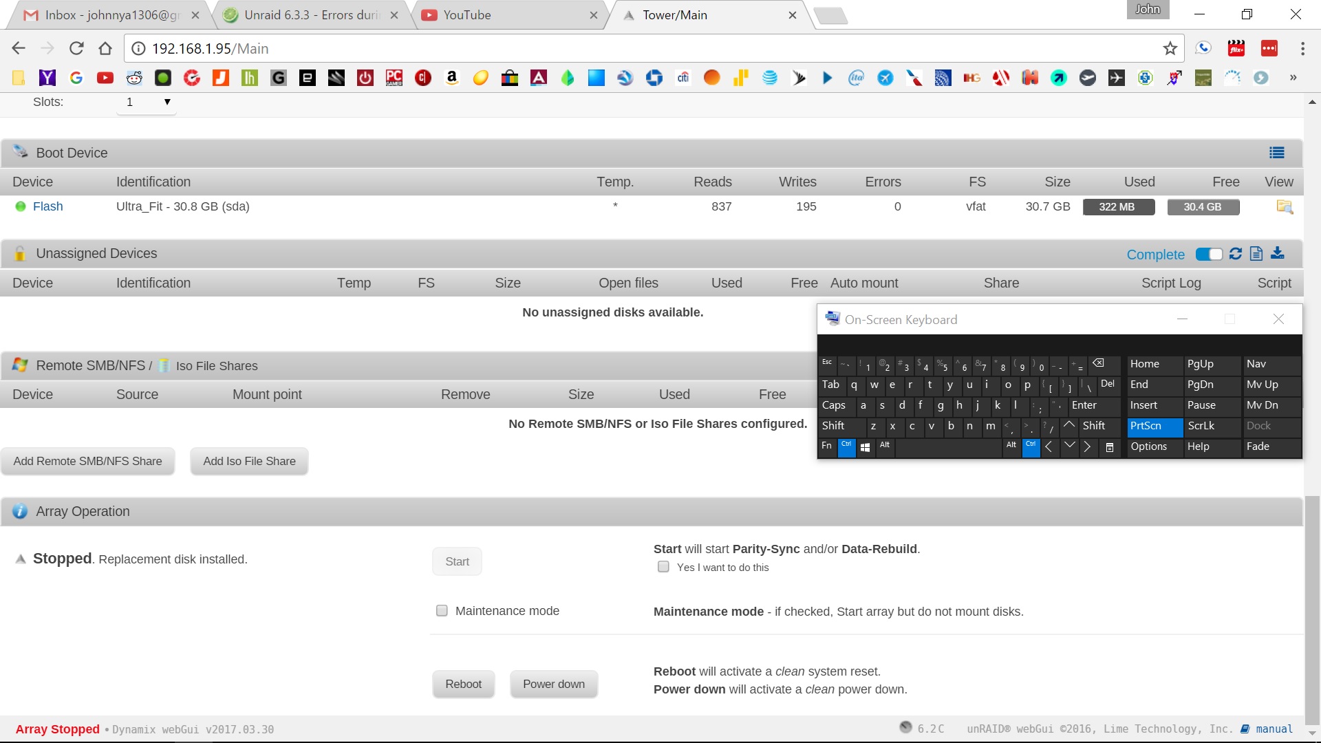

There isn't a "parity is already valid" box.
Only "replacement disk installed"
You need to do a new config, tools -> new config -> retain all disks
Then assign old parity and don't forget to check the box before starting the array.
