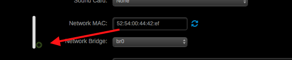

Make sure you're in the advanced view of the vm manager (toggle basic/advanced on top left side)
then under the network area, click the green + sign to add another network adapter.
