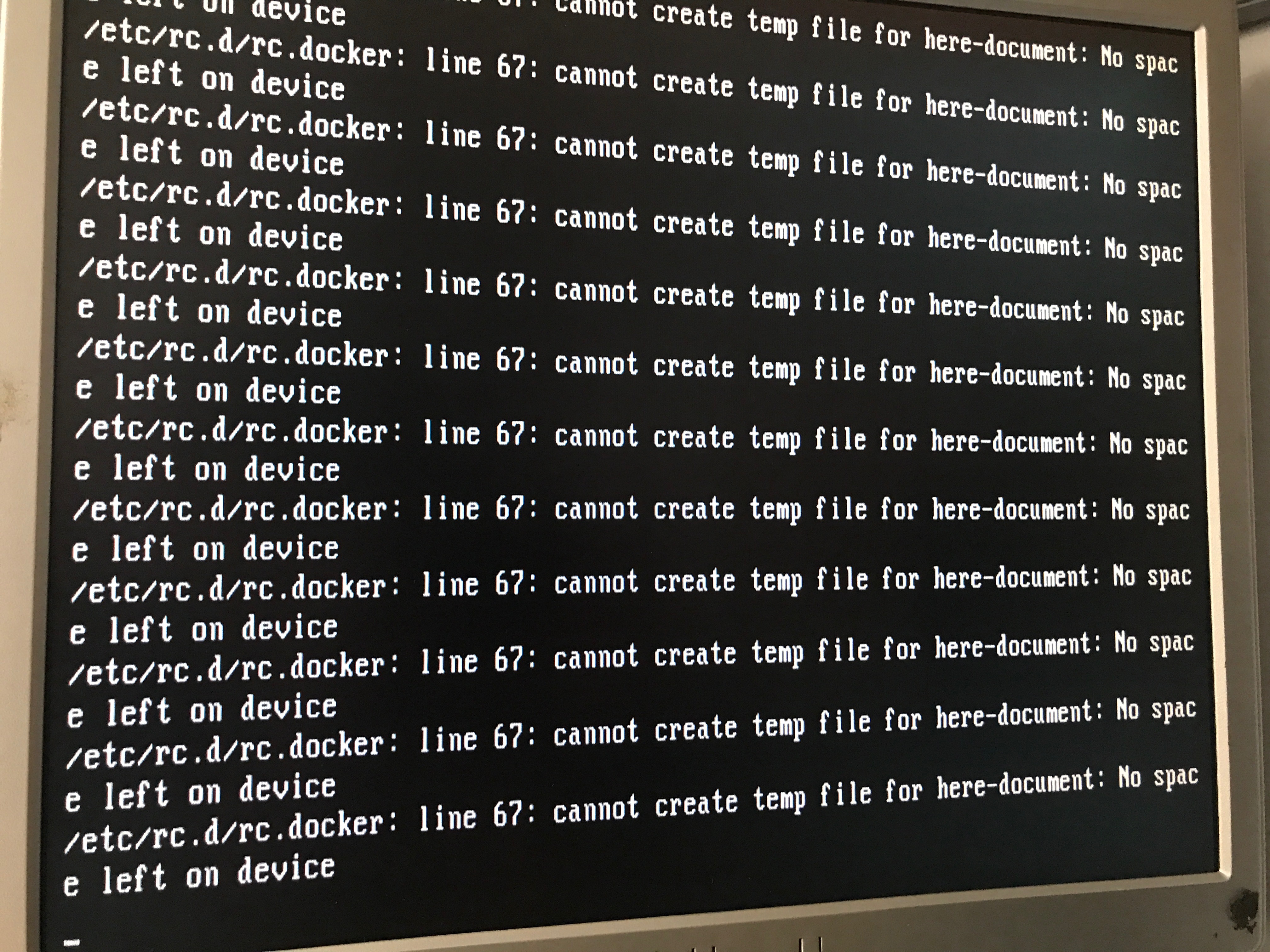

I boot the server and just spawn erros saying /etc/rc.d/rc.docker: line 67 cannot create temp file for here-document: No space left on device

Diagnostics are basically empty because your ram is completely full
Reboot into Safe Mode and then try posting the diagnostics again.
If they're still basically empty, then post your docker.cfg file from the flash drive (config/docker.cfg)

but no erros
6 minutes ago, Squid said:
Settings Disk Settings. Change Start Array to be "no"
Reboot normally
When its back up, Hit the log button in the top right and leave the window open
Then start the array (Main tab, Array Operation)
Once the errors start, copy and paste the output from the log window here
this is my screen
Something is very quickly filling your ram.  Best guess is a docker severely misconfigured.
Disable all containers from autostarting from the docker tab.
Reboot
Then start one at a time until those errors appear
Reboot
That is the problem all the docker are turn off from the boot
Reboot
If I trie to turn on I get this erro
Execution error
Server error
Edited by JohnPeace
Uninstall the swap file plugin and try again (reboot)
Sent from my LG-D852 using Tapatalk
done no more erros I going to turn on all dockers
