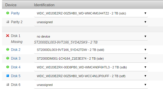

A week ago I added a new 5th disk to my array as I was running out of space, this disk was added successfully..
A couple of days later I noticed it had errors on it so checked the logs and saw it had bad sectors so I took it out hoping the store would replace it but they needed for a couple of days for testing, so I ended up buying  another disk and as I was pre-clearing the new disk to replace the other drive I just bought a week ago in the array I lost another disk fml :( . now I cannot do anything I cannot bring my array online (Too many wrong and/or missing disks!)
Please can someone tell me there is way of fixing this, I have to much data that I don't want to lose..

thank you for the reply, i only lost one drive but unfortunately since i added the new drive a week ago and that had issue i went to swap it out and now while pre-clearing the new drive again i lost an old drive i think its just bad timing, i have checked all my cabling and the controller and all seems in order, thanks for the advice :)

@johnnie Blask. its a hardware array so i would assume if it was cabling i would lose all 4 disks as it one cable into the motherboard but will double check everything is nice and tight.
@bjp999, thanks for check the rest of the disk, they are all very full about 100GB free on each one hence me trying to add another disk to the array, the disk that are currently there are also very old :( ..
So im assuming that my DISK1 has failed it's broken i'm not getting it back, is there a way to remove DISK5 as it is new and i did not have much data on it ? i can try make unraid think that there was only one disk failure and then i can add the new drive to disk1 so it can get rebuilt ?
Other than that what would i need to do to bring this array on line again ?
Thanks..
No, if you can get disk1 online and depending on if there were any changes to the array after it went offline, you may still be able to recover data from disks 1 and 5.
If you can't get disk1 online you'll lose all data from both disks 1 and 5.

So i have been able to test a bit further this evening and have found that DISK1 is completely dead if i swap disk 1 for a new disk the array picks it up instantly..
So am i safe to assume i have lost all my data on DISK1?
is there is nothing i can do to make unraid rebuild the new disk, is there no hacks where i can in the config file remove disk 5 so it looks like i only had one disk fail and hopefully get unraid to rebuild DISK1?
thanks in advance :)
You could but without disk5 parity won't be valid and it would only rebuild garbage.
