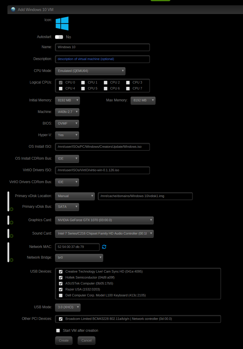

create a windows 10 vm from template (see attached) using same Primary vDisk.
