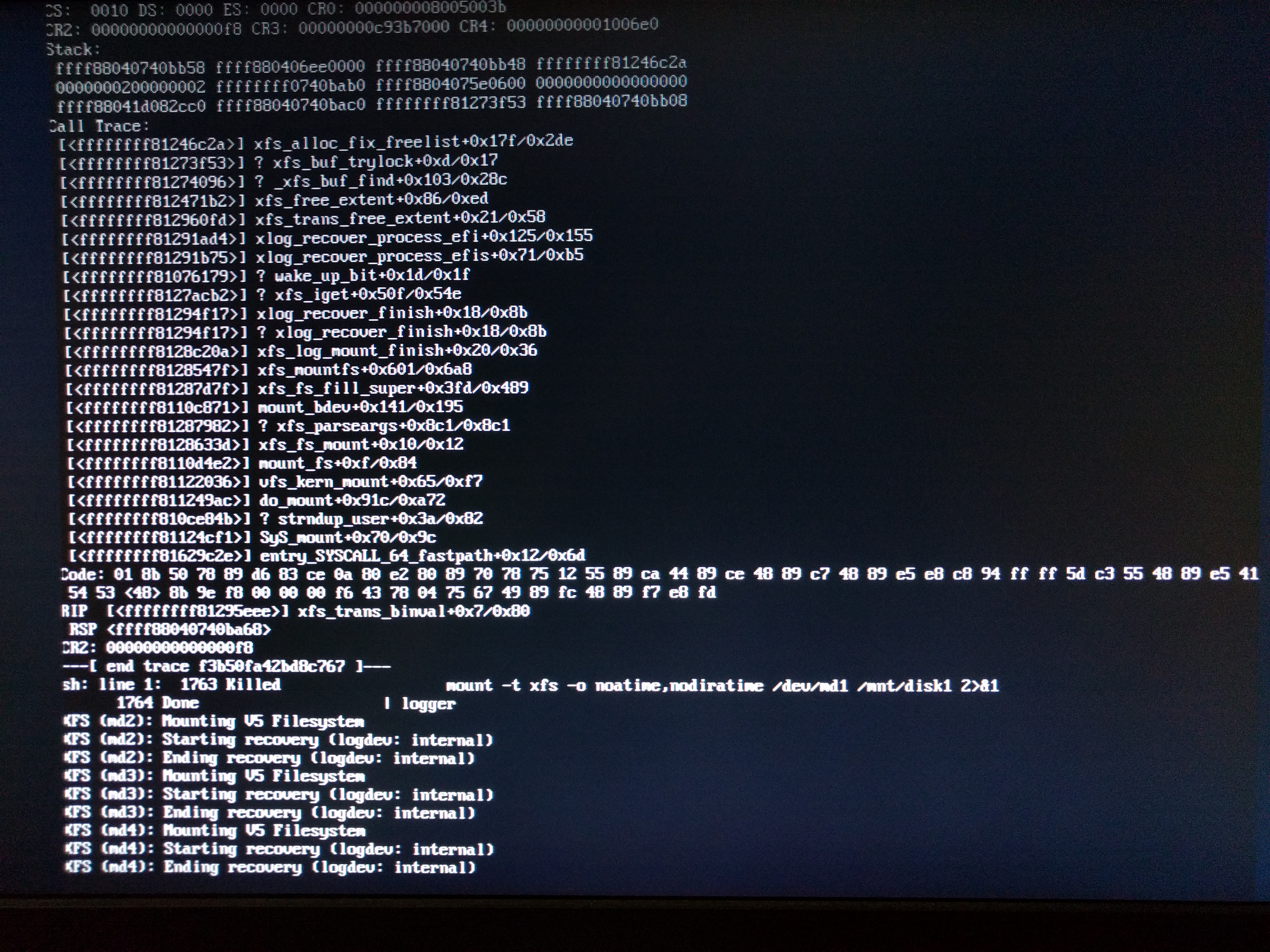

I let Windows try to fix any errors but it just said it finished scanning and didn't find any errors. I booted the system on a monitor in both regular and safe mode and it hangs at the same point in boot up shown in the picture:
You need to disable array auto start and run xfs_repair on disk1.

I did what you suggested and here is what I got when I tried to check the file system on disk 1:
"root@UNRAID:~# xfs_repair -v /dev/md1
Phase 1 - find and verify superblock...
        - block cache size set to 1472440 entries
Phase 2 - using internal log
        - zero log...
zero_log: head block 2942888 tail block 2942567
ERROR: The filesystem has valuable metadata changes in a log which needs to
be replayed.  Mount the filesystem to replay the log, and unmount it before
re-running xfs_repair.  If you are unable to mount the filesystem, then use
the -L option to destroy the log and attempt a repair.
Note that destroying the log may cause corruption -- please attempt a mount
of the filesystem before doing this."
I did what this suggested and tried to mount the file system so it could replay the log file but after 20 minutes or so the web gui was still unable to mount the file system. Right now the system is stuck trying to mount the file system so I can't even take the array back to maintenance mode, any suggestion would be appreciated.
I could add the -L switch to the command string but wanted to make sure there wasn't something else to do before that as it looks like I might lose some data. Also, I wanted to find out where in the string, "xfs_repair -v /dev/md1", the "-L" should go. Many thanks in advance.
Use -L, it's normal in these situations and usually there's no data loss.
Ran the repair and everything is back up and running, thanks!
