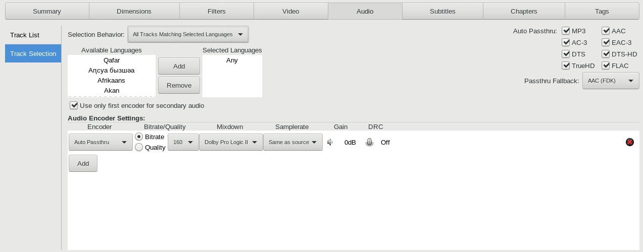

Hi, I'm struggling with my audio default. I've been looking for a while and can't figure it out.
I just want the audio to be untouched with only the video compressed. I set all "Auto passthru behaviour" to checked but when I look at the GUI it always shows that it is going to convert it to AAC (which it does to the file in the output folder)
I exported the preset file and it shows as:
      "AlignAVStart": false,
      "AudioCopyMask": [
        "copy:aac",
        "copy:ac3",
        "copy:dtshd",
        "copy:dts",
        "copy:mp3",
        "copy:truehd",
        "copy:flac",
        "copy:eac3"
But I have to manually alter the GUI for every file. This is also happening on my Windows computer so I guess it's a preset fault rather than a docker fault but I wonder if someone here could help.
Thanks

Here is how the audio settings should be configured:
Ah thank you!
For some reason I had misunderstood that lower section as "definitely mixing down" due to the DPL box. I'll give it a go tonight :)
