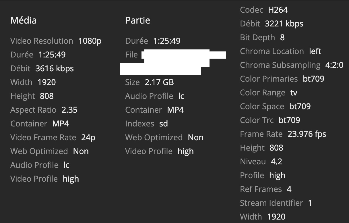

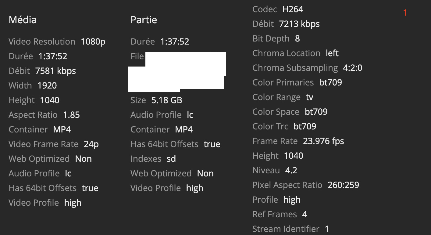

Yes, in Plex ! Look these images.
The first one work, and the second not.
Edited by Jobine
I just converted it to level 4.1 and it does't work anymore.
