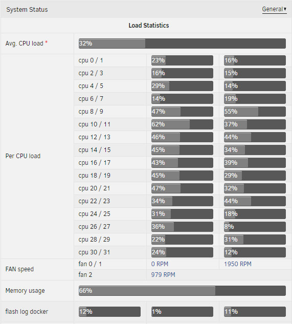

I am runnung this docker on a 2950X Threadripper but the docker is barely pressuring any of the 16 cores resulting in approx 30fps HEVC encoding compared to 55fps I get on my 8700K
The cores/threads usage according to unraid is very low, any ideas?

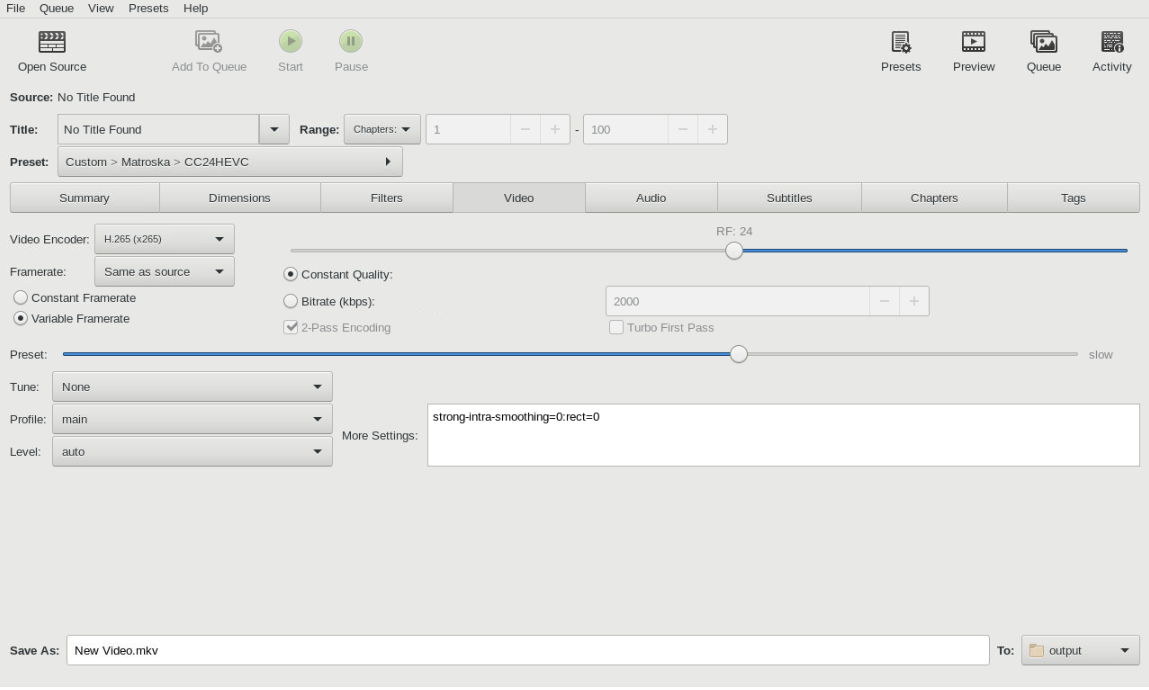

What's your encoder preset? I had mine at "faster" and I dropped it down to "medium" or "slow" and now the usage is high. Try that.
I use a custom preset which is the same as I use on my 8700K which uses all available cpu so it is something in the docker I have not got set quite right
1023855804_ScreenShot2019-03-06at8_27_24AM.thumb.png.01c63845cc9d867e796d970cfc0dcaa0.png
This is what I'm talking about. What is yours set to?

You caught me. I'm running two setups. I have my primary Unraid server which has this docker setup and running,  it is converting all the items as their downloaded,  but I have also setup a standalone Kubuntu machine running on an older PC I just retired. I'm trying to use it to work thru all my old files to cut the work time down.  Thus I'm trying to execute the HB docker from the CLI as there is no container environment.
4 hours ago, CrunchyToast said:
This seems to be working so far. I had to create a custom script for Radarr and Sonarr separately.
  1. Move or Episode is downloaded and imported
  2. Custom script copies file to the /watch directory
  3. File is encoded
  4. After encoding, file is moved to the /output directory then copied to overwrite the original file

I'm not sure what could be the problem.  Maybe encoder optimizations are better for Intel than AMD.  Try to check on HandBrake forum to see if there is a known issue.  You could also try the development version ("dev-latest" tag) to see if you have the same performance.
Thanks for the reply 🙂 I am getting similar fps using less cores (4 instead of 12) and find it uses more of the 4 cores than 16 so curious! I will let you know my findings!
