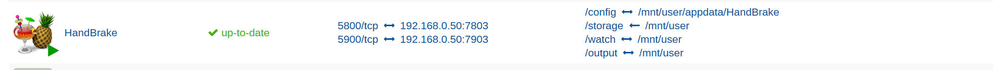

Hello I have the same problem with read/write permissions, I've set my output to /mnt/user see photo - Any guidance please?

On 5/18/2017 at 10:56 PM, tiny-e said:
Just installed.  Any time I try to queue or convert I get an error complaining about can't read/write to the directory (ones I chose in the setup).
Hello, I have the same issue with read and write permissions, I've checked & read and write is enabled for both source and output folders (I've enclosed pdf doc, showing pics of configs, errors and cut & pasted logs, any guidance appreciated)?
Handbreak read&write issues.pdf
Edited by huntjules
