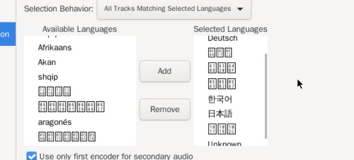

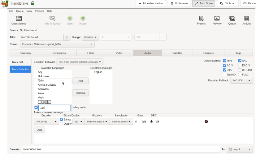

Hey Guys, having an issue with no Japanese as an available language in the Audio Track Selection. Anyone have any ideas?
I've seen on the github issues for this project that it should be listed in Kanji (日本人) however the docker container doesn't seem to have the character set for many languages. If you see in my screenshot the last in the list is depicted as multiple alphanumeric squares, does anyone know how to fix it?
Try to edit the container configuration and add a variable named "ENABLE_CJK_FONT" with a value of "1".
See https://github.com/jlesage/docker-handbrake#environment-variables
Hey Mate, thanks for your help!
That has worked perfectly but only for Kanji characters, there are still other character sets missing for other languages, although I don't need them myself it might be useful for people in the future if there's a solution to all?
Enabling ENABLE_CJK_FONT installs fonts from the following project: http://wenq.org/wqy2/index.cgi?action=browse&id=Home&lang=en
Not sure what else is missing.

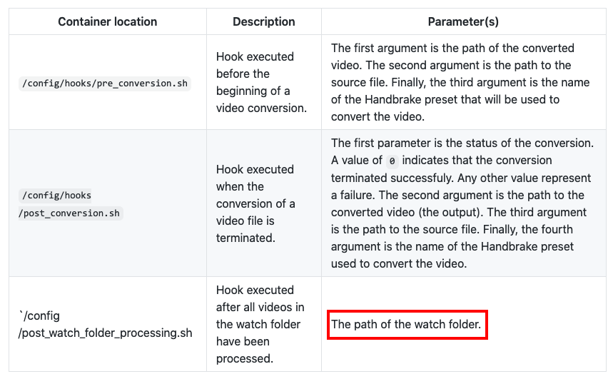

Just for my understanding though, am I misinterpreting the table on the hooks page? I'm using post_watch_folder_processing.sh
On 3/5/2021 at 5:36 PM, Jorgen said:
Thanks, hardcoding "/watch" made it work again, of course. :)
Sorry, I though you were talking about the post conversion hook.
So I verified the post watch folder hook, and there is definitively an issue with the param passed to the script.  I will fix that.
