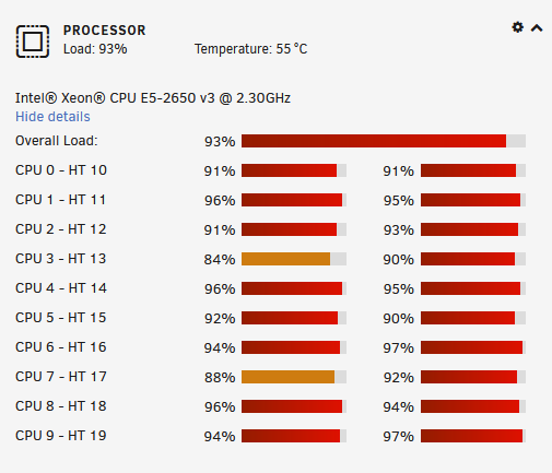

1 minute ago, C_James said:
im saying usage. that my bad. was typing the reply while in and out of a siege game. and okay. 81c does seem a little high for not all of the cores. i would check in case temps or reapply the thermal paste. 90 c is where ryzen thermal slows down.
So but when you run the handbrake docker, what do the core utilizations look like?
running handbrake now so here a screenshot.

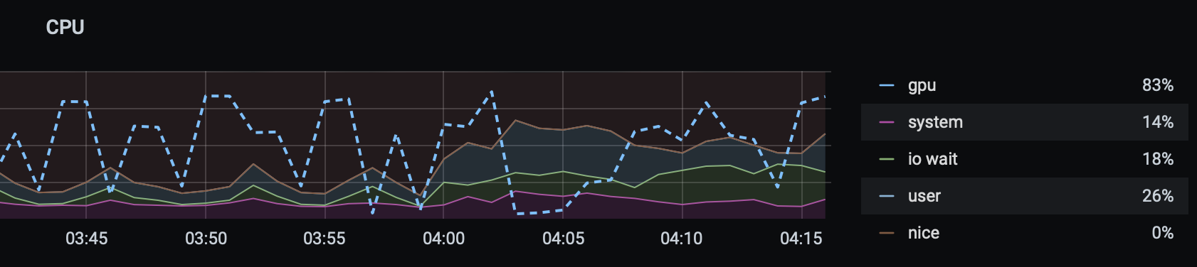

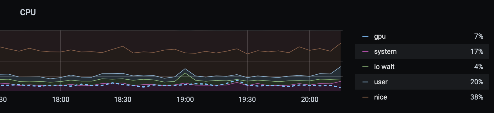

Just to follow up on my issue, I tried changing the "niceness" to give this docker highest priority and that didn't make a difference. I ended up dedicating fewer cores, and now those remaining cores are going in the 90%+ range. So I guess I have more CPU than handbrake knows what to do with?

Interesting. My conversions are noticeably faster with hardware encoding than pure CPU so it must be doing something.
Here are graphs of GPU utilization (dashed line) courtesy of gpu-monitor.
Emby transcoding:
1203226138_ScreenShot2021-07-19at8_17_53PM.thumb.png.ce4d23f86bb27aea9c7d13a968fb4956.png
Handbrake hardware conversion:
1276852347_ScreenShot2021-07-19at8_16_02PM.thumb.png.b4108de1abc7a0690fe81b6729b08e1b.png
Both using the intel quicksync driver and assigned to 3 CPUs.
I wonder what accounts for the difference.
Have you passed /dev/dri to both? I use QSV in Handbrake just fine.

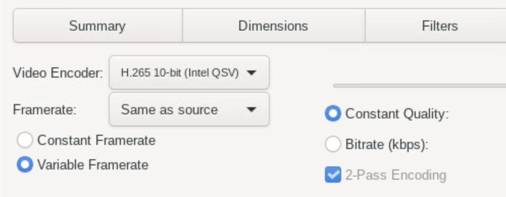

Yes. You can see it working in second graph (Handbrake conversion.) The GPU's utilized but at a much lower level vs Emby. Seems this problem's unique to me but will post if I make any progress.
Note: I have all video encoding filters disabled in Handbrake settings.
What encoder are you using in Handbrake?
Intel QSV:
Well then from what I've seen it does indeed look like Handbrake isn't using QSV, but I know it works, I've done it myself. What CPU are you running it on?
